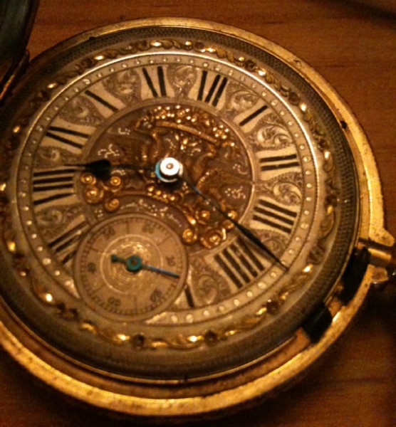

I've just been asked to see if I can find out anything about this watch and I noticed it is certainly not common in my opinion. The escapement is unusual I believe it is a spring detent but am not sure as I haven't seen one before, if anyone could confirm or deny this it would be great. I've posted a slow motion YouTube clip (
Here) and the pictures should help. The case is a beautiful 18 karat one with detailed designs which seem to include some type of bird, maybe a phoenix. The dial is just as nice being extremely intricate and well made. The watch did come in a Longines box but I can't find any markings. I apologise because the pictures I've taken don't really do the watch justice, but they were the best I could take at the time. Any information at all would be appreciated. Thanks,
Joe

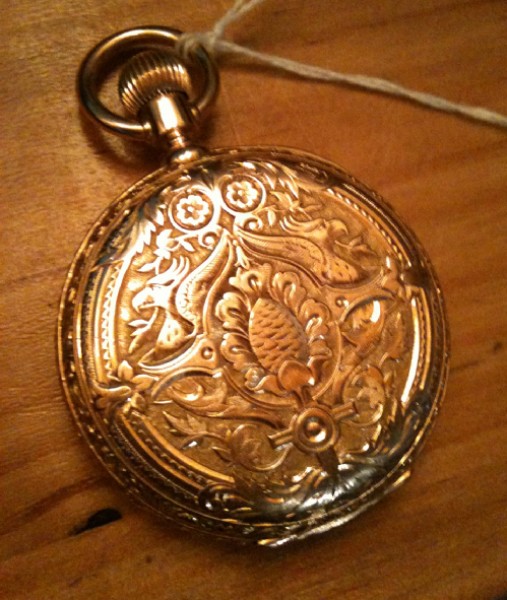

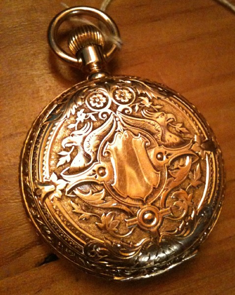

Joe BradleyFront of the watch.
November 06, 2013, 16:20
Joe BradleyBack of the watch.
Joe BradleyDial
November 06, 2013, 16:21

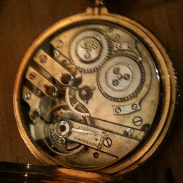

Joe BradleyMovement.

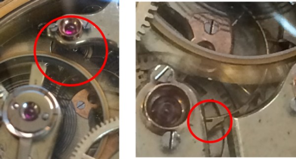

Joe BradleyThis one shows my reasoning for saying it's a spring detent. The small hairspring in the first picture seems to fit with what I know, as does the shape of the escape wheel teeth.

Gerald ZimmermannHi Joe
Pretty nice watches you come along .
The escapement is indeed a detent escapement but it is the pivot detent escapement (or pivoted detent escapement).
It is a bit of confusing:
- a pivot detent escapement has a pivoted lever, a balanced rocker moving on the pivot and hold by a small 'hairspring' to allow a proper locking/unlocking.
example - a spring detent escapement is 'springy' itself, a long thin piece of spring steel fixed at the very end opposing the balance wheel.
example the escape wheels are the same in both cases.
swiss made ca 1880

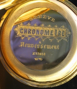

Ethan LipsigI have a very similar pivot detent chronometer: same sort of fancy 18k case, same sort of fancy embossed dial, same style of movement, same lack of signature. Mine likely is in better condition than yours, but yours still is a very nice watch.
You don't show a photo of the cuvette. My watch's cuvette does not identify the maker but it does say "Geneve. Chronometre a Renversement. No. 63488." After this, there is a symbol of a left facing key. "Chronometre a Renversement" means "detent chronometre." What does the cuvette of your watch say, if anything?

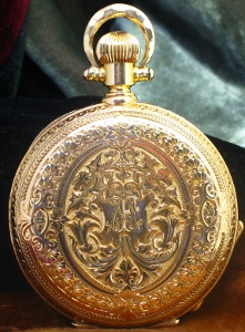

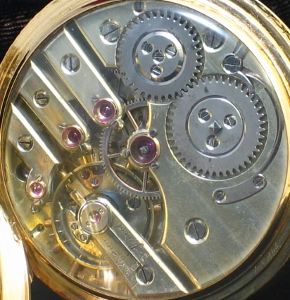

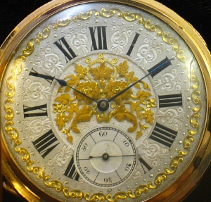

Ethan LipsigHere is a photo of my watch's case.
November 17, 2013, 04:58
Ethan LipsigHere's its dial.
Ethan LipsigHere's its movement.
November 18, 2013, 17:54

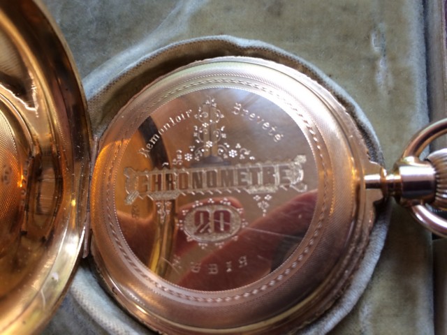

Joe BradleyHere's the photo, sorry it took too long, like I said it isn't the same as yours and "Remontoir" just means it is key wind. I did also notice what looks like a makers mark in the back of the case, possibly RF, does your have anything like that? Ill try to post of photo of that soon too. Thanks,
Joe.

Ethan LipsigThe case of my watch just has serial number and 18k markings, but no maker's mark. The cuvette on my watch is quite different from the cuvette on your watch. See the photo below.
("Remontoir" does not mean "key wind"; it's meaning has evovled, but most lately was used to refer to keyless stem winding.)
November 22, 2013, 19:12
Joe BradleyYes I can see the differences, but I still think they likely originate from the same place, and sorry about the remontoir mistake I meant to write what you said, I may not be experienced but I can still recognize a key wind
