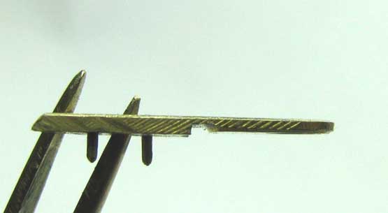

This next shot should illustrate the fragility of this piece nicely!
The thickness of the escape cock in my example is 0.80mm by the pins, 0.62mm near the jewel, and 0.35mm in the machined recess!
For those of you working in 'old money' - imperial measures, the thinnest point on this escape cock is
14 thousandths of an inch!
You poke around with a screwdriver at the wrong end at your peril!
One final point about this part: if you buy a cylinder watch (Especially on eBay) that is being sold with a broken mainspring, Beware!
There are occasions when the recoil down the train from a fully wound spring 'letting go', will bend or break it.
The recoil will be stopped suddenly when the escape tooth hits either the inner or outer wall of the cylinder - and something usually gets busted or bent - or both!
The weakest part will break as a rule, and this is one of them - along with stripped train wheel teeth - and a bent cylinder - the 'giveaway' here is a balance rim that 'wobbles' as it rotates!!
John
