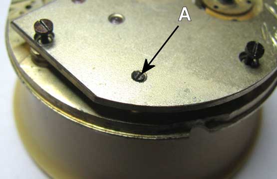

Another type of dial foot retainer used on these and many other Swiss watches, is a knife edge type screw.
This screw has either a flat or a notch milled on one side to clear the foot.
The dial feet protrude through the dial plate, and the screws, which are set close to the edge of the feet are turned, causing the knife edge of the disc to cut into the copper foot.
As the screws are turned further, they pull on the feet so pulling the dial tighter to the dial plate.
The danger is that if a dial foot is pulled too far, it will draw the copper back of the dial (to which the dial foot is welded) away from the enamel, breaking it up in the process - a Very common sight being holes in the dial enamel over an overtightened foot.
The dial screws are actually turned 'Anti-clockwise' to tighten dial feet, and 'Clockwise' to loosen them.
So to loosen the dial foot to remove the dial, the screw needs to be 'tightened' into the dial plate - but only sufficiently that the 'flat' or notch releases the foot.!
Sometimes the flat won't clear the foot even when tightened fully against the dial plate, so you have no option but to go the other way, and hope the flat will clear the pin and release it before the dial breaks!

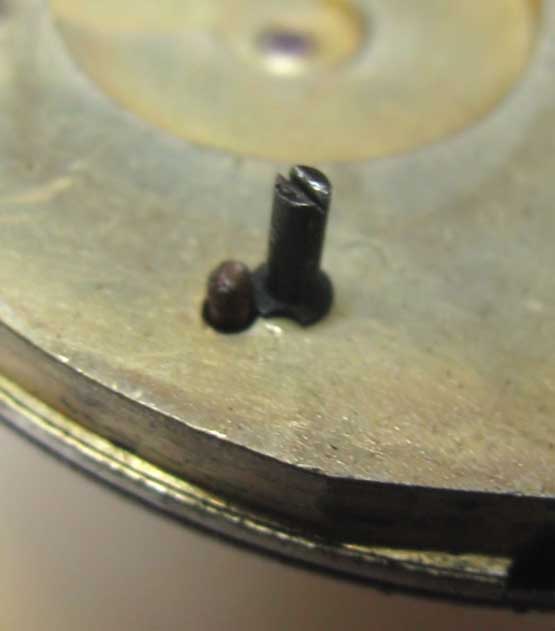

The photo below shows a typical knife edged screw with a circular notch.

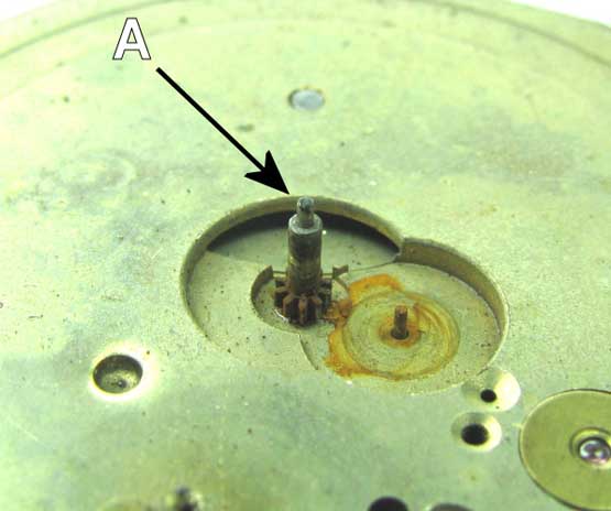

John WoolseyThe 'giveaway' (and often 'boobytraps' for the unwary) on 3/4 plate movements like yours that there Are screws securing the dial feet, is an 'extra' srew head visible on the backplate, as in the photo below.
(Arrow A)

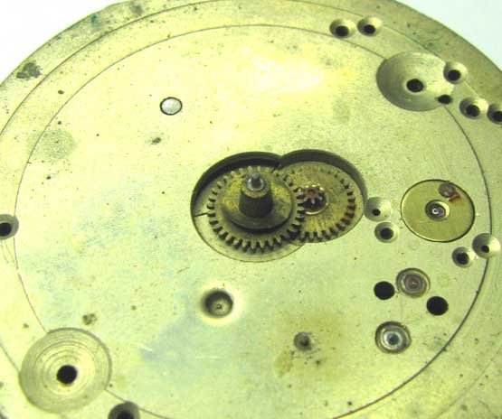

John WoolseyHaving got the dial unfastened, place the movement dial up on the movement holder, and gently work the dial off the movement, often they will take a bit of shifting if a gorilla has overtightened a dial foot and bent it!
With the dial off, you will then see the motionwork which drives the hands.
This is basically a 12:1 reduction gear on a watch with a 12 hour dial. It would be 24:1 reduction for a watch with a 24 hour dial!
So for a 12 hour dial, and for every full turn of the cannon pinion (Minute hand), the hour wheel (Hour Hand) moves 1/12th of a revolution of the dial and is represented by hour markers, which also correspond to each 5 minutes marked.
The gears are calculated and cut to accurately represent this, so the gears from one watch will not necessarily work in another, and in the case of Swiss watches, it will be almost akin to winning the lottery if you Do find a match!
Try not to damage or lose them!

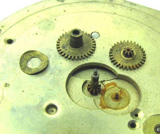

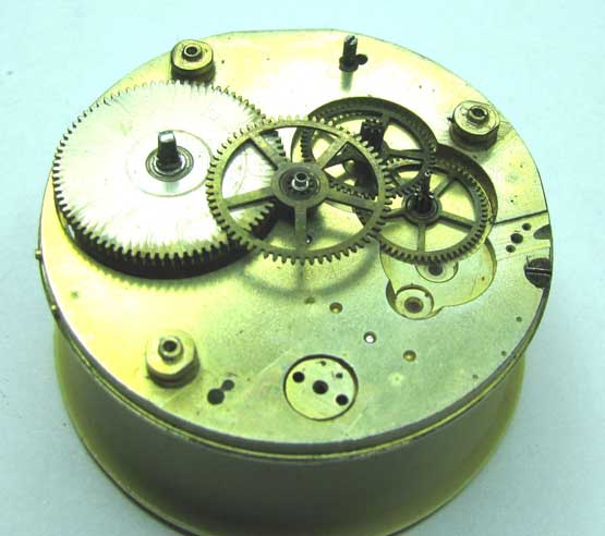

John WoolseyThe next shot shows the component parts of the motionwork lifted off.
At the centre of the movement is the cannon pinion, which is driven by the train of the watch.
The large wheel with the smaller gear at the centre is the 'minute wheel' and driven by the cannon pinion, which in turn drives the larger gear which has the 'pipe' at the centre. This last gear is the 'hour wheel' onto which the hour hand is pressed.
The smaller gear in the centre of the minute wheel, is the 'Minute Wheel Pinion'
The minute hand is pressed onto the small diameter pin, seen protruding through the centre of the cannon pinion.
The small belled washer, is a 'dial washer' which is situated between the dial and the hour wheel, acting as a small spring to keep the hour wheel in in contact with the cannon pinion and Minute Wheel.
Without this washer, and because of the clearance between the dial and hour wheel, there is a tendency for the hour wheel to lift clear of the minute wheel pinion which drives it, stopping the hour hand moving!
Let me know if you're with me so far!

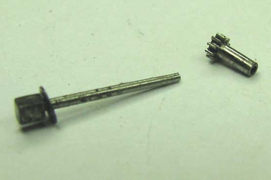

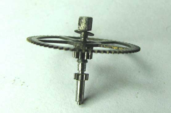

The first photo, is of the hands setting pin and cannon pinion, to illustrate what you will be removing!
John

John WoolseyThis shot shows the pin through the hollow centre post, with the cannon pinion placed on the end.
The eagle eyed amongst you will no doubt spot the outrageous amount of wear on the centre wheel pivot!
This is a common sight on non jewelled centre wheels - and if you find rust in your watch like there is in my example, you can expect to find similar wear!

John WoolseyOk, so having set your movement 'Key square down' on a movement holder, lightly tap the end of the pin (arrowed) with either a small watchmaker's hammer, or using a small punch too if you have one, and it should drop through.
These are generally not too tight!
Lift off the now loose cannon pinion and place in your parts tray with all the other bits you've removed so far!
Then turn over the movement, and draw the pin out - with its dust cap (washer) if it has one!

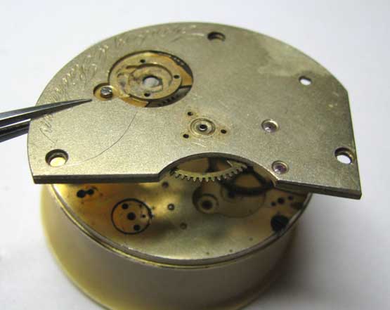

John WoolseyNext step is to take out the plate screws, and lift off the backplate.
In the example I've shown below, the centre wheel has come off with the plate - this is because the wear and dirt on the pivot is binding it in the pivot hole.
Hopefully, the plate on yours will lift off leaving the wheel behind.
If it does start to come away with the plate, you can gently push the wheel down with a bit of pegwood or a toothpick at the centre to keep it in place.
Using a screwdriver to do this could gall or distort the wall of the pivot tube as it's quite thin at this point, so preferably use something softer than steel.

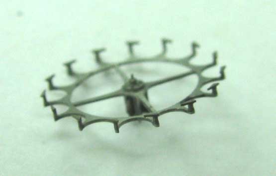

John WoolseyThis is a cylinder escape wheel!
This shot illustrates why the cylinder itself has an 'L' shaped slot in its wall!
The head as well as the post it sits on has to enter the cylinder!

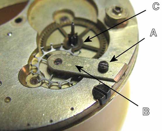

Taking a slight step backwards on the topic, I'll cover taking off the escape wheel cock, as it is deserved of a special mention = if only to prevent the unwary wrecking a movement!
Depending upon your movement, and whether or not it has a sub seconds dial, removal of the fourth wheel ('C' shown under the escape wheel) may depend upon the escape wheel being removed first.
This is because the close proximity of the 4th wheel to the underside of the escape wheel, plus the seconds hand pinion extending a long way through the jewel (or pivot hole) doesn't allow sufficient clearance for the gear to be lifted out.
If no seconds hand pinion is there, then usually there's room for the 4th wheel to lift out as the pivot is short.
The escape cocks on cylinder types, are usually only held by one screw (A), but on the underside there are two quite deep locating pins, which can occasionally be quite tight.
Please don't wedge a screwdriver under the jewelled end to prise the thing off!
Chances are if you've got tight pins there, you'll snap the escape cock in two - or at least bend it!
It may look a beefy chunk from the top, but the next images will show just how fragile this piece is!
More to follow after the image
John.

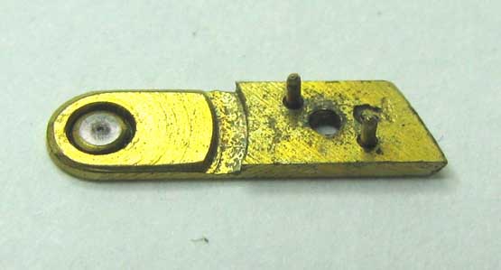

John WoolseyAs you can see on the image below, the underside of the escape cock is relieved, this is to clear the tops of the escape wheel teeth - which substantially reduces the thickness of an already fragile brass casting!
As the locating pins are much deeper than the thickness of the relieved area of the escape cock, there is a danger that prising it up from the jewel/pivot end, will break it before the pins are clear!
This one has had the relief area machined quite nicely, many however, you will find have been hacked out with a file or graver - possibly to accommodate wear on pivots and jewel holes (and escape wheel tilting over), which means the wall thickness at the thinnest point can leave you wondering if it's only the gilding holding the piece together!
So why so thin!
Because the escape teeth act virtually on the centreline of the balance, it doesn't take a genius to work out that the balance rim by default, has to swing over the top of the escape cock.
Because ebauche makers try to keep the height of movements low to keep watches thinner, by necessity, the escape cock has to be as close as possible to the dial / pillar plate, to keep the height of the balance rim and cylinder to a minimum!
