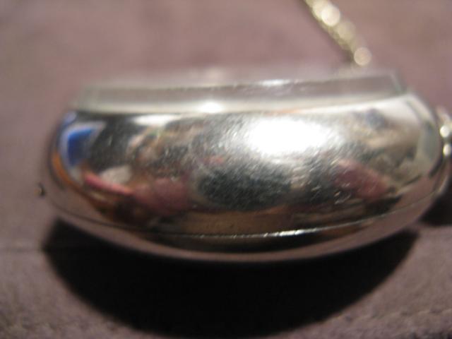

David AbbeThis Elgin takes this whole thing to the limit!

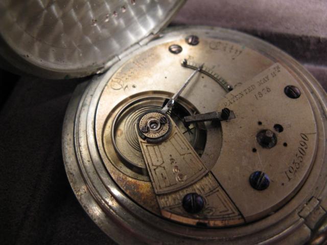

Mike Sandell
Hey David I got one of those to but the one I got is a side winder does your case have a patent date of APR 5,1881 Fathys coin No 1 3oz in the case

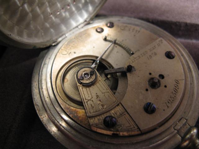

Mike Sandell
Here is one that is just like the top one it's most likly a two peice case some call them pair cases.

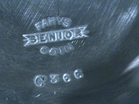

David AbbeMary Ann, that is right a 1 piece pair case. It is kinda ackward to pull out the movement.
Mike, this is the case marking I photographed for this watch. I am going to list it on eBay or IHC this week.
