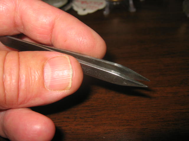

David AbbeThe "antimagnetic" type are generally low grade stainless, and not recommended for our work. There are some very very expensive ones, but a demagnetizer (which you will end up with anyway) will do just fine to "clean up" tools and (more important) watches. Mean while my "working" tweezers are a stubby "H" (?) type I derusted from the eBay tools, and reworked to an excellent "touch" tweezers which with lightly sanded inside jaws will positively pick up a fly's eyelash if so needed.

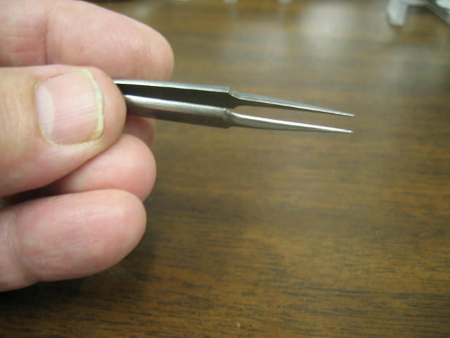

July 06, 2008, 13:26
David AbbeThat is as opposed to my favorite #5 (another de-rusted eBay find) That I used for manipulating train wheels in final assembly and, from time to time to "help" a damaged balance (hair) spring

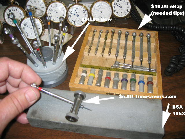

David AbbeAs for screwdrivers, I first bought some Bergeon whirly-gig mounted drivers, and then some more "old" sets from eBay which I converted into "backups" so I needent stop and resharpen during a project. Most important is to have a basic sharpener (at least) learn to use it to redress the tips, (I use my old Boy Scout Sharpening stone), and to buy good blades. Cas-Ker has some very nice blued steel replacement blades at very attractive prices.

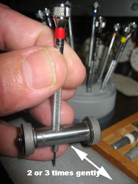

David AbbeTo answer the question about my cross dressing the tip, if you look at some movement plates it looks like the last watchmaker was using a John Deere
PLOW to screw them together! I cross dress the tips because it makes me feel better about thinking I will not slide the driver out of the screw slot so much and mark up the movement plates. As you must dress the tip a little anyway, the way I do it is shown by the motion arrows:
