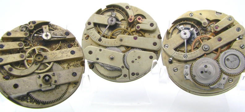

Thanks John,
Hi Chris I emailed last night,
thought I would post these parts watches for fun to show similar example, left and center Locle

Hi Chris. Nice shots. My movement is similar to the one on the right and center and my dial is like the one on the left, but it is not in that bad shape, actually it is in rather good shape for it's age.
