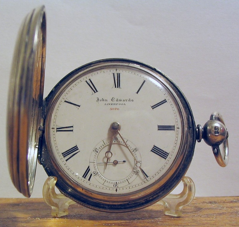

Donald C. HendersonI got another one. It has the table lever escapement this time and is in a Hunter case. I didn't have an 18s Hunter nor a lever fusee so it fits both niches. It's thinner than the verge watch and it's in great condition with almost no wear to the case other than a few small dings. The dial is absolutely perfect and the gold hands are also very good. It runs 30 hours on a full wind and keeps excellent time. The John Edwards, Liverpool markings are also on the movement. It is hallmarked as Sterling Silver with a London town mark and the date code for 1865. The pendant and bow are also hallmarked. It's fully jeweled with a diamond end cap on the balance. It must have been a high end watch in it's day.
No oil has been used on this one.

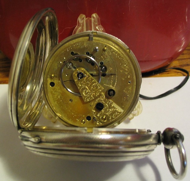

Donald C. HendersonMovement A little blurred sorry.
It has the dust cap which was removed for the picture.

David BuckdenAs you’ve no doubt discovered, ‘John Edwards’ isn’t listed as a Liverpool/late 19C watchmaker by Baillie or Loomes. It’s possible that this is a retailer’s branding – you could try
https://liverpoolhistorysociet...tions.wordpress.com/ - in order to research that.
You may already be aware that ‘John Edwards’ was a sub-brand used by the Tobias firm for its lower quality Liverpool-made products. I believe some people owning Edwards watches don’t like this idea as it’s been said that this name was applied to Tobias ‘3rd grade’ watches. However, I have found a reference which confirms the usage, but links the name to ‘2nd grade’ products, which is more palatable for an owner! I also think that it may be that some examples of ‘John Edwards’ are better quality than the standard output of some of the contemporary Liverpool makers.
December 29, 2015, 16:54
Donald C. HendersonI wasn't aware of any of that since I have none of those reference materials. What is your reference confirming the connection to Tobias? I can't find anything that's more than conjecture and rumor. Even the Wm. Robinson connection seems to be under debate. From what I've found, however, the large jewels are similar to what was used in Tobias watches.
Would a "3rd grade" watch be fully jeweled with a diamond end cap like mine? Would even a "2nd grade" one be?
December 29, 2015, 17:54
David BuckdenI was referring to a report of a talk given by Alan Treherne in February 1987 at a meeting of the Northern Section of the Antiquarian Horological Society. He had been in the U.S. the previous year, researching various matters, including the importation of watches made by M Tobias & Co. In the course of this he learned: "A letter from Tobias to a Baltimore wholesaler revealed that second grade watches were named Robinson or Edwards."
Donald - with your interest in English watchmaking in the 19th century, I'm sure you'd benefit from becoming a member of the AHS - have a look at the Society's website:
http://www.ahsoc.org/ Regarding the gradings, as with many aspects of the old English watch trade, it was not especially well regulated and documented. Specifications changed all the time and neat definitions of models/grades often just don't exist. Proper processes and conformity was better done by the U.S. makers, reflecting the much more industrialised approach practised there.
December 30, 2015, 15:11
Donald C. HendersonThank you very much for the information. Knowing that the watch was made by the Tobias company is interesting. Considering it's condition after 150 years, I'm more than pleased with it whatever grade it was considered to be in it's day. Maybe the solid balance wheel denotes a grade under top drawer? I read that the higher end Tobias watches sometimes had a compensated balance.
