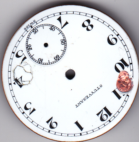

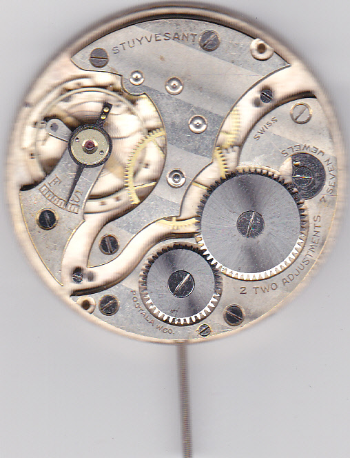

Here is a scan of Dial (needs repair) and movement with wrong stem.
August 05, 2015, 10:26
Melvin Siedman
Dial
August 07, 2015, 00:23
Bila Wirriganwalters
Looks to me like a "A Michel 500 calibre" 17 Lignes movement, best fit part#A17 would be the stem if it is. A under the dial picture would help shed more light on it.

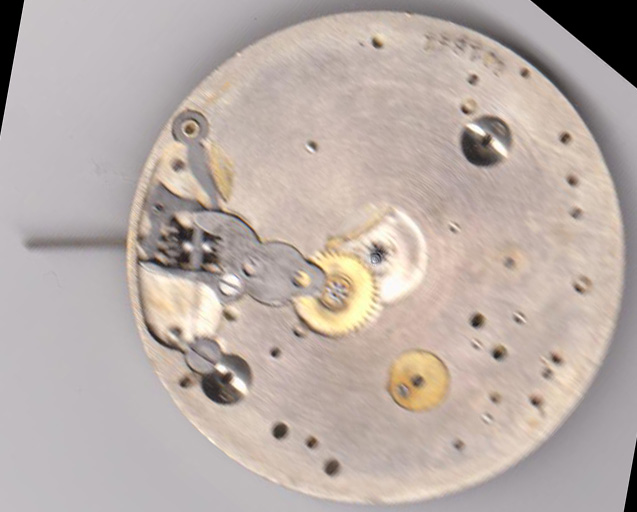

August 07, 2015, 11:44
Melvin Siedman
Not the best picture I've ever taken.
Mel
August 07, 2015, 19:24
Not a problem Mel, it is good enough to so the mechanism. It does not look like any setting arrangement I have seen on "A Michel" watches, so I'm stumped.
From the back plate looks like one, from the front does not, sorry I wasn't more help but I have exhausted my reference library.
