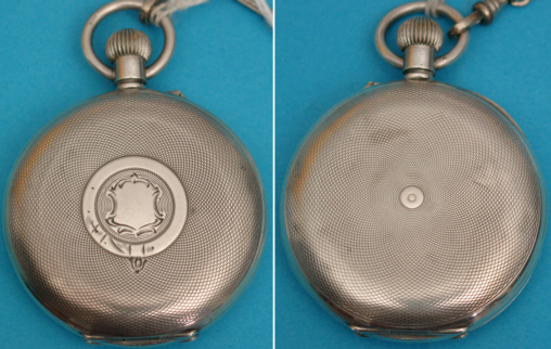

This watch came to me in a box lot of 8 that were sold as junkers. I bought them to practice on and this one turned out OK. It is a 16 size solid silver case and apart from some minor dings on the back it is in reasonable condition.

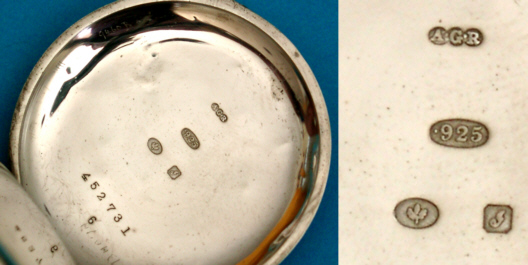

I believe it is pre ww1 due to the pin set but can not get closer. Here are the hallmarks that someone may be able to identify.

I can't quite make out the year letter, but the casemaker AGR appears to be:
Arthur George Rendell,(Importers),
40/42, Clerkenwell Rd, Clerkenwell.
He registered the same mark consecutively on:
25 June 1907,
2. July 1902,
3 Sept 1907,
2 Aug 1916
and 1 July 1919.
The dates may not be exhaustive, as I've no idea how up to date my book is.

The three leaf stamp is a Chester Import mark, and the date letter appears most like a cursive G (for 1907) to me, but it could also be a J (for 1909). The shape of the cartouche is slightly atypical for those, so I could be completely off.
Interesting watch, and a neat piece of local color.
Cary

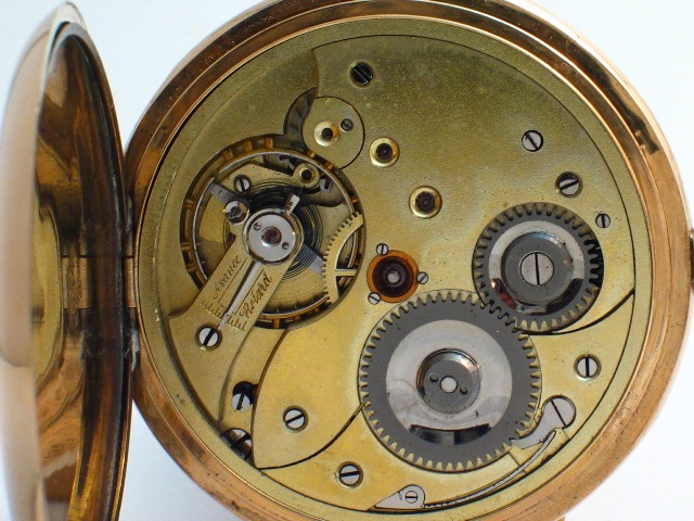

Ethan Lipsig
The Swiss made watches that imitated the style of Glasshutte makers, such as Lange. These watches were priced well below the German originals, but often were of reasonably high quality and often cased in solid gold cases. The picture below is an of an example I used to own. The movement is not identical to yours, but the two resemble each other in a number of ways. Since I cannot identify the maker of the watch pictured below, I cannot identify the maker of your watch.
