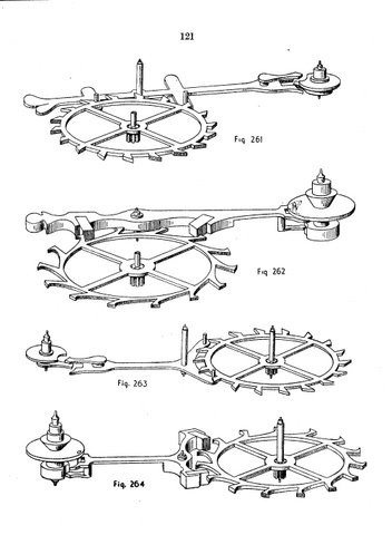

Where I can see a pic of clubfoot escape.

The Club tooth escape wheel is shown as fig 261 and 263 while 262 and 264 are our more "normal" escape wheels for American Watches which have "toes".
The two Pallet designs for these are the "lever" and "anchor" types (using english terminology).
(pg 121, "Watch Escapements" by Dr, James Pellaton, N A G Press Ltd, England., c.a. 1920)

Thanks David.
And thanks for the explaining and pics.
