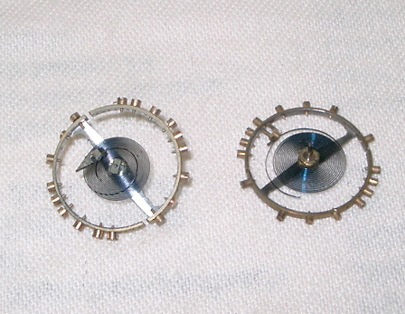

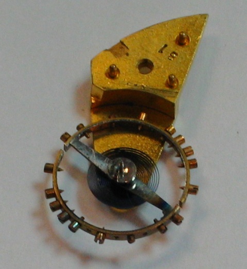

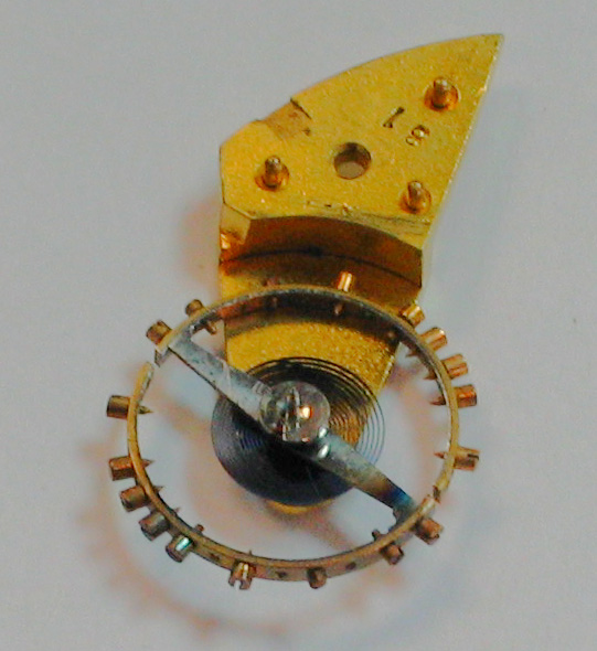

I've posted below, photo's of a couple of balances with hairsprings which should show the differences reasonably clearly. The spring on the left is an 'Overcoil' as attributed to Breguet, and the other a 'Flat Spiral'. I also have one with a Helical spring somewhere and will post one of that too if I manage to unearth it.
Essentially, a Flat spiral is just that, it sprials outwards from the centre, is placed through curb pins (or a combination boot and curb pin) and into the stud on the balance cock - all in one plane - Flat!.
An Overcoil or a Breguet Overcoil (your choice, whichever you wish to call them), starts of as a flat type, but at some point has the final coil curved upwards then parallel to, and across the spring, to again pass through either curb pins or a combination boot / curb pin and into the retaining stud.
I took a quick look in De Carle's book, and he shows illustrations of no less than 220 or so different curve profiles for an overcoil (left or right hand curves) and doubtless there are many more - which gives some idea just how complex this subject is!.
To be honest, manipulation and callibration of hairsprings is a black art that I've never really mastered - mostly from lack of practice (and shakey hands). I've very often also come away from reading authoritative texts on the subject feeling that I know even less than I started with ....... great subject for curing insomnia too which doesn't help!

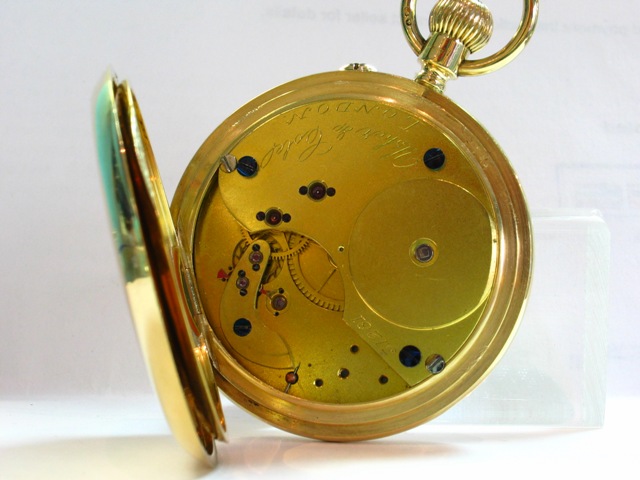

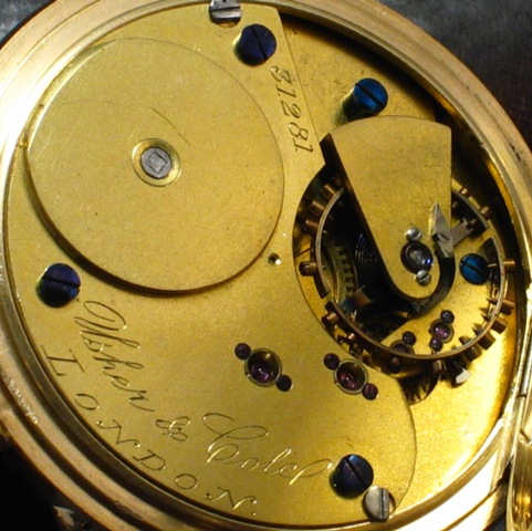

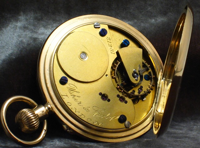

Ethan LipsigJohn, you asked for more information about, and more detailed photos of, the Usher & Cole escapement. It is an English side lever escapement. The escape wheel teeth are club shaped. See the photos that follow.

John WoolseyEthan,
Apologies for the delay replying ...... tooo many domestic pressures!
Thanks a million for these pic's, they really are great help.
If it's not too much hassle for you, could you help with one or two things that aren't too clear?
Your watch appears to have been an English Lever movement that has been converted as mine has, to a Swiss lever escapement (Club tooth wheel).
I can't see the pallets in the pic's but it looks as if they're fixed under the lever?
Are the pallets jewel stones set in cages as we now commonly see, or do they appear to be thin 'slips' set in notches in the pallet arms?
Does the guard pin (the bit sticking up on the end of the lever fork) appear to be made of brass or steel or is it a jewel?
I can't see the roller on the balance too good, is there any chance you could describe it for me at all?.
Is it a double roller ie: 2x discs on one assembly,one of the discs having a notch (for the guard pin) and the other with the jewel set in it?
Or is it a single disc with both a notch and jewel pin?
Sorry about the questions!
If it's easier, you could always mail me the photo's you have, so I can enlarge and lighten them a tad.

Ethan LipsigJohn, unlike most members of this Chapter, I have zero watchmaking skill and no tools. I will have to take this watch back to my watchmaker for further exploration and photos. Give me a week or two.

John WoolseyYikes .......... truly no need to go to those lengths for me Ethan, but the offer was really appreciated all the same.
I'm sure the guy will probably remember what was in there anyway without seeing the watch again.
To be honest, if the photo's could be lightened a touch, I'm sure I'd be able to make out what the roller arrangement is, and that would do fine to be honest.
Regarding the pallets, if you take a close look at the arms where they drop and lock on the escape wheel teeth, are the jewels clearly visible? (as in a typical later Swiss or American lever watch).
If all you can see are steel arms and no jewels, they'll be slip inserts, but the slips are so fine, you may not see the slit cut into the ends of the arms or the inserts.
You've really given me some solid ground to work with here though, and I'm in with a real chance of finishing off the conversion properly.
A million thanks for this!

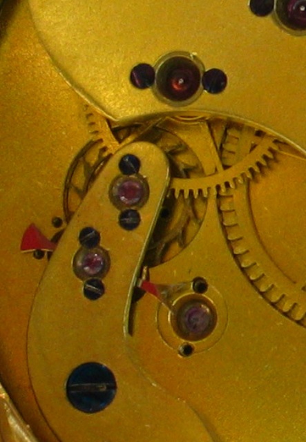

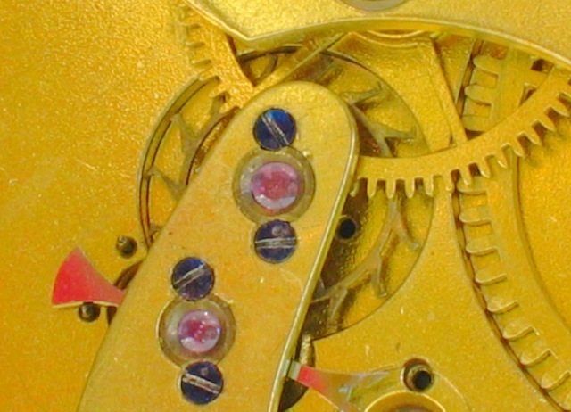

Ethan LipsigUntil I visit my watchmaker, perhaps this will suffice. I understand the watch to have a double roller. I am attaching a series of lightened pictures.
December 11, 2007, 10:36
John WoolseyMany thanks for lightening the photo's Ethan, there's a bit more visible to go on now.
I could be wrong, but I think your watch may have a single roller table, as the jewel pin would appear to drop down into the fork, whereas the guard pin next to the fork is vertical and probably locate in a crescent next to the jewel pin.
As I say, I could be way off here as I can't make it out too clear.
The pallet faces may have jewel slips, as the lever appears banked and the line of the pallet face looks as if it would lock the escape wheel.
Jewel stones would be fairly visible if fitted maybe.
Thanks again for taking the trouble to edit the pic's, really appreciated.
Best regards
John
December 13, 2007, 14:14
John WoolseyYou know John, there do look to be two jewel pins on that table! First time I've come across that!
I thought it may have been a reflection, but maybe not!
I never twigged the fork opening either, I assumed it was just different magnification on the pic's.
Would be great if you could get confirmation of it for us Ethan!

Ethan LipsigMy watchmaker and I re-examined the Usher & Cole.
The watch has a single roller. There is just one jewel pin on the roller table. The palette has English-style jewel slip inserts.

John WoolseyMany thanks for going the extra mile here Ethan, it really is appreciated.
I had wondered about converting my watch back to an English Lever escapement, but I'll probably stick with the Swiss style now after seeing how yours is set up - it'll be one bit less to fiddle around with anyway.
Time to sit down and have a serious think about it now!
