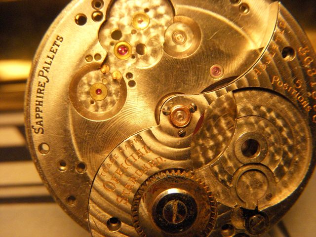

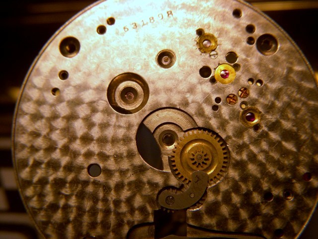

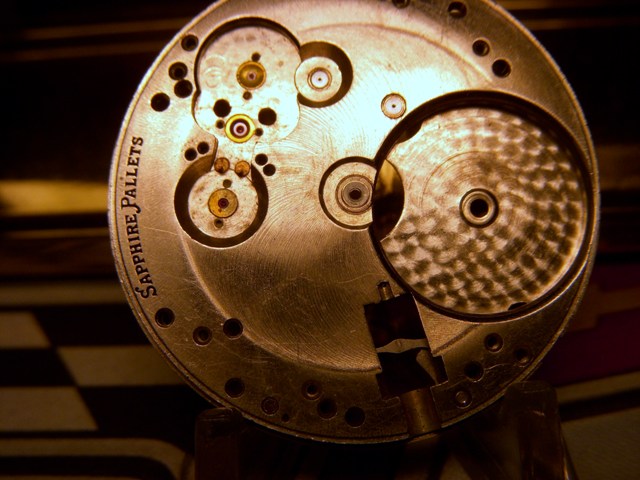

I have a partical 16 size 21 jewel marked ball open face movement. The serial number is easy B631898 and that's on both plates balance cock bridge and train bridge. Which suggest it's is a hamilton.
I have not been able to determine what I have. So I have a few question I hope this body can answer.
1.Will ball hamilton plates fit on ball waltham plates and will the screw holes line up. properly
2. Did ball make any 21 jewel waltham 16 size that did not have the ball round madallion on the movement.
3. what model waltham movement did ball use for the waltham ball,since he used 992 hamilton parts for the 999.
Here are the pics of my watch:

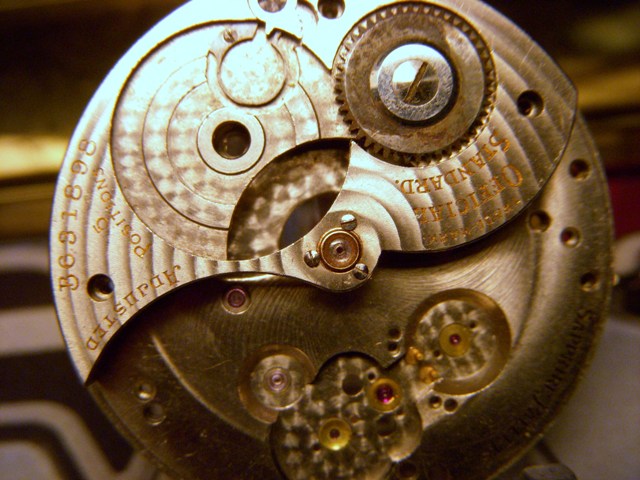

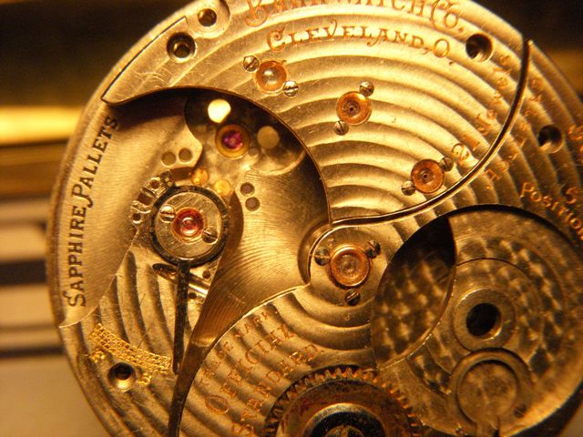

So, here are my pics, Now can anyone anyone explain to me which I have here. Is it a Waltham or is it a Hamilton. Now if it is a Hamilton, which movement did Ball use cause it sure in not a 992.
December 07, 2012, 10:05
Edward L. Parsons, Jr.1. No, in general, the plates will not interchange between Ball-Walthams and 16S Ball-Hamiltons.
2. Yes, the later 16S Ball Hamiltons had no medallion.
3. I think they called it a model 99, not to be confused with the model 1899, which has a totally different plate layout.
For more info, do a search from the main page.
I know yours is a Ball-Hamilton from the movement number B631898 and the fact that there's no medallion. There is no corresponding "twin" Hamilton movement for this watch. That didn't happen until later, with the 992B and the 999B -- those watches have interchangeable parts.

Thomas CouplesEd, Thanks again, I thought so, as stated in earlier post but what model movement hamilton. No hamilton I ever saw used the pallet bridge assembly as this one. Any ideas I am at a loss here.
I have what I THINK is a ball hamilton parts movement that I am restoring with the intent to sell to one of my customers. The dial side plate however will not accept the standard 992 pallet bride, but the plate fits perfect with the lower plate and all screw holes line up perfect.So I am at a loss on what to do . Thats why I asked if ball used different hamilton movements and if so what did they use. I have never seen hamilton use any other pallet configuration other than the standard round ones you find on 992 for their 16 size 21 jewel watches.

Thomas CouplesOk,here goes,I have a ball movement that I have for restoration.We have decided it's a hamilton. The problem is that the pallet bridge is not a 992 which as I understand ball used for all his 999's. If you look on ebay at the item 160935853056 you will see if you look at the pallet bridge is not the same as the 992.Yet it's a hamilton,but which model. That why the above observation in my earlier post.
December 07, 2012, 12:06
Richard RomeroThomas,
Webb C. Ball had company’s manufacture watches to his specifications so the 16 size 999 was made by Hamilton and some parts such as wheels, staffs, springs and jewels might be interchangeable with a 992. It would make sense that Hamilton would use whatever parts they already had available to fit the guidelines that Mr. Ball needed. The 18 size Ball 999 I have needed a shipper lever spring and mainspring and those parts are the same ones used for a Hamilton 940. Likewise the 16 size 999 probably uses a Hamilton mainspring that was used for the 992 or similar grade.
Hamilton used 3 different pallets for the 992 and there is not just one pallet bridge for all 992 movements. The pallet bridge you need is for a Ball-Hamilton 16 size 999 made for Ball and will not be found on any 992 period.
The pallet bridge you seek was made by Hamilton specifically for the Ball-Hamilton 999 16 size to meet the specifications Mr. Ball required and is a unique pallet bridge for those movements.

Thomas,
Unfortunately, what you have is a parts movement, that and nothing more.
Someone took the entire balance bridge and escapement, as well as numerous other parts, looks like all the good stuff is gone, that is typical of picked-over parts movements. It is also important to recognize that NOTHING from a Ball-Waltham will fit on a Ball-Hamilton movement, except perhaps the hands,
even the case screws are of a different design. And as others pointed out above the parts you need are NOT on a Hamilton 992 movement. Here is a topic where we explained the easiest way to tell whether you have a Ball-Hamilton or Ball-Waltham movement.
Click for: Ball-Hamilton or Ball-Waltham 16-size Movement???
Ed said it well when he pointed out it was not until the 992B and 999B era that there was, except for plates which were damaskeened and marked differently, near-complete interchangeability between Ball-Hamilton and Hamilton movements of the same time-frame. Several others explained some of the other details, but basically your parts movement which began as Ball-Hamilton number B631898 is likely beyond hope unless you can scarf a few screws or some of the jewels from it, again sadly "the good stuff is gone" from this one.
For more, here is a topic wherein we get into production numbers of the 16-size Ball-Hamilton watches and some commentary that help detail them with some specificity...
Click for: 16-size Ball-Hamilton 999 and 999B Movement Numbers and Years Listing
There you will see, yours is one of 41,000 total 21-Jewel Grade 999 variant known as "No Seal, Going Barrel" and 1924-1942 production. Some of your remaining parts can be used on those and other Ball-Hamiltons produced between 1910 and 1942 but you could not reasonably build a credible watch out of what you have. Some of the missing parts were numbered and specially fit, it would not be right to put dissimilarly numbered parts together.
