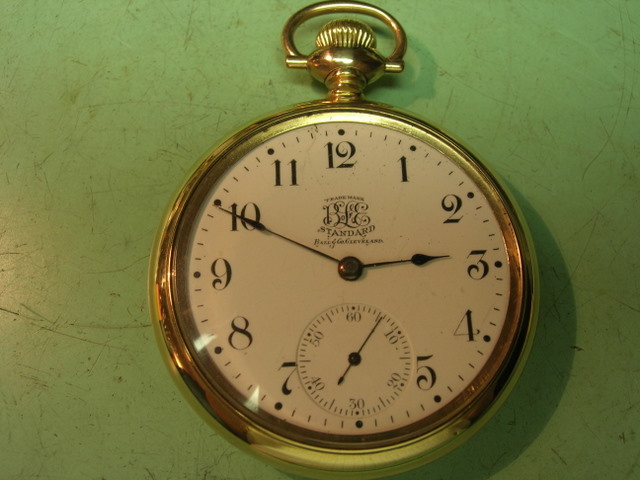

Joel W. SarichBall - Waltham B of L E Pocket Watch
I have a Ball - Waltham number B0554395 which is a 16 size, 19 jewel B of L E watch.

Nice item Joel,
Interestingly yours is B0554395 and I have a nearly identical 19-Jewel BofLE number B0554261 in my collection. Both watches are of course from the same 1901 Ball-Waltham run.

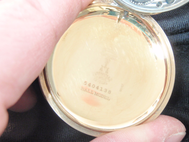

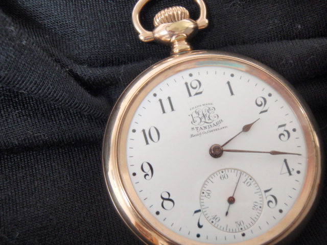

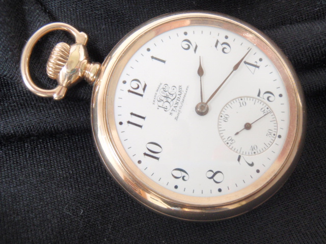

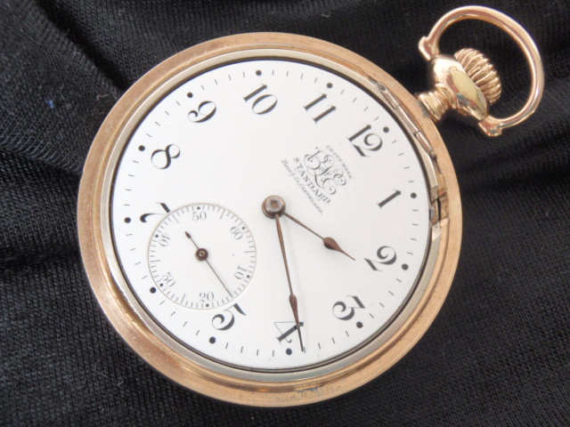

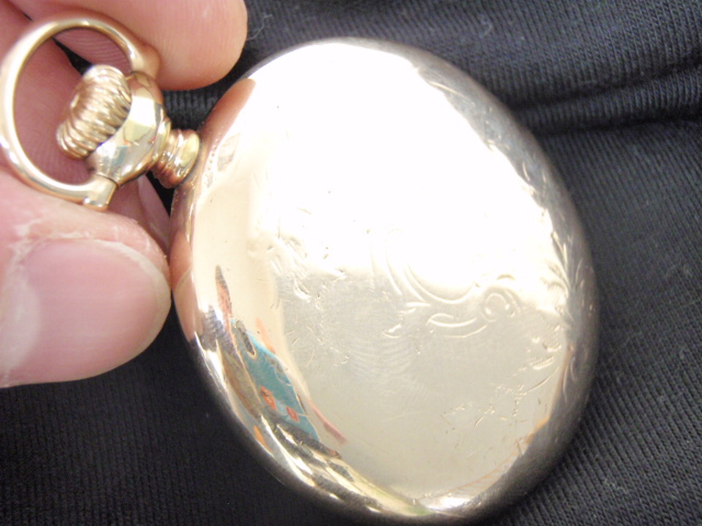

Joseph PierzynskiHi Gents, attached are pic's of the 16s Ball Watch Co, Ball Waltham B of LE I just aquired. The serial # is B0505612. Hi Lindell, Hi Bill, can you tell me what yr this was made? I don't have a reliable database for Ball Walthams and any other info or comments on this watch is truely welcome. The balance is perfectly true but needs a cleaning badly, there is some litgh spotting on the small winding wheel and the gold BLE plug is there. The dial is beautiful with a slight hairline under the subseconds dial. The case is a Ball Model gold filled swing out with a pattern back.
November 02, 2011, 14:37
Joseph Pierzynskidial
November 02, 2011, 14:38
Joseph Pierzynskidial no bezel
Joseph Pierzynskidial angle

Joseph Pierzynskicase inside back
November 02, 2011, 14:55
Joseph Pierzynskicase back
November 02, 2011, 14:56
Joseph Pierzynskicase back 2

Hi Joe,
You have a very nice example there!
Nearly everything looks to be correctly marked and likely original right down to the correct seconds hand. The only incorrect component I see is the hour hand. That should be comparatively easy to find. The seconds hands were often knocked off as were the minutes hand, usually the hour hand avoids loss or damage.
As to the production year, your number B0505612 is from a mixed-run of 500 of the 17 and 19-Jewel Ball-Waltham movements consisting of B505501 through B506000 during 1901 production, interestingly it turns out there are five runs of 500 listed for that year! As a further side-note there were about 64,000 of the 16-size Railroad Grade Ball-Walthams in 17, 19 and 21-Jewel configurations between 1899 and 1922 which shows they were very popular then as they are now. I am a big believer in 19-Jewel watches, these rank high among my personal favorites and furthermore I have often heard knowledgeable watchmakers say the 19-Jewel Ball-Walthams were one of the strongest and most reliable watches ever made.
One final point, we believe these 16-size Ball-Walthams were the first Ball watches to be sold in specifically marked as "Ball-Model" cases and from my observations this likely began right after the turn of the 20th Century certainly by 1901 production. It would then be several years before this would spread across to the 18-size Ball-Hamiltons around the 1905-06 time-frame.
