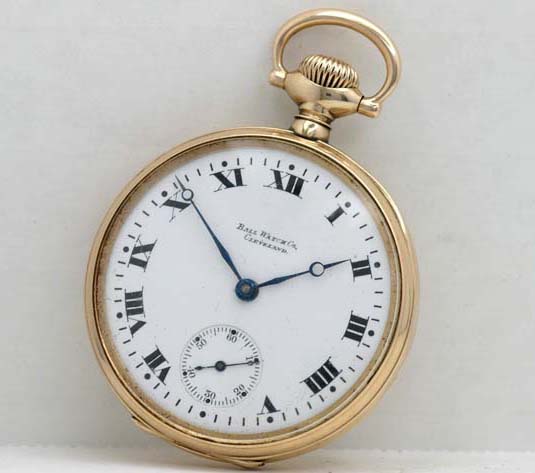

I have a picture of the dial of the watch below.
Nick

I see you've posted your dial picture, I think what you have would of been more of a dress watch, not approved for railway service.

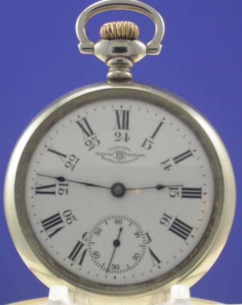

Here is a photo of my Ball Waltham 16 size, 17 jewel, Serial No. B-237948. it has a 24-hour Roman numeral dial marked Ball Official RR Standard that would have been approved for railway service in Western Canada.

I agree with Larry, your dial would not have been considered Railroad Grade in the U.S. at the time your watch was produced. That dial signature "Ball Watch Co., Cleveland" is also something I would normally associate with Ball Commercial Standard Watches in most instances.

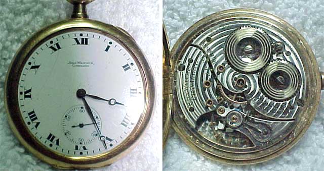

Another one like Nick's watch on eBay right now?
ebay

The one Bill found on eBay is a Ball-Waltham 12-size Commercial Standard (Right Ed! Smile) and interestingly it has the same style dial and hands as Nick's watch but it is the 12-size version whereas Nick has a 16-size watch. This is where Ball-Waltham watches become very confusing in addition to being very, very interesting.
Examine the next two images very carefully, the train bridges are shaped differently, that is definitive.
Dial and movement on the 12-size Bill asked about...

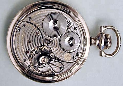

Notice the different shape of the movements plates, most particularly shape of the train bridges, between the 12-size Ball-Waltham (above) and the 16-size shown in the image you see below.
Typical 16-size Ball-Walthan movement to compare...
