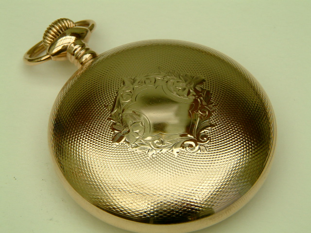

Peter NicholsonI find it difficult buy good quality American pocket watches in very good cases on this side of the pond. This early 21 jewel 1892 Vanguard in a Dueber coin silver hunter case is one of the better ones.
September 03, 2013, 09:30
Peter NicholsonAs is this Hamilton 946 in a Wadsworth Pilot 14K gold filled case.
