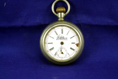

I just bought this on e-bay. It is a Swiss size 20,movement 785630, Swiss special, case 0314502.The movement is lever set with screw on front and back. The movement and dial are marked PRW Co. Is this a real railroad watch? I am a beginner at collecting and repair so any help would be appreciated. Thank you.
railroad watch PR&WCo

Hi Kevin
I can't tell for sure from your photos but you watch maybe be what is called a Swiss fake. If you search the site for swiss fake you will find many examples of them. We have all bought one along the line.

Hi Kevin, I researched the eBay sale and have all good news for you!
1. At $40.00 and change your "lesson" was not too expensive. Actually the watch might be repairable!
2. The case is very interesting, as I have not seen that Trademark before. It is certainly worth what you paid for the auction.

The "Giveaway" for many "Swiss Fakes" is the Uncut Balance wheel, and as you learn more about the other parts, you can also see the Micro-Regulator is very crude. That all said, this watch is amazing because of the great lengths someone went to to make it "look" American. Had they spent the same time just making a nice watch I think that it would have sold equally well or better.
It would be fun to try and get it running again.

Kevin in my part of the country watches like yours were often (in the politically incorrect days of my youth) called Gypsy watches or peddlers watches. They were sold to the gullable as high grade watches. Many are found with large red or blue glass "jewels" that are non functional but catch your eye. They are an interesting area of watch collecting and some still work!
