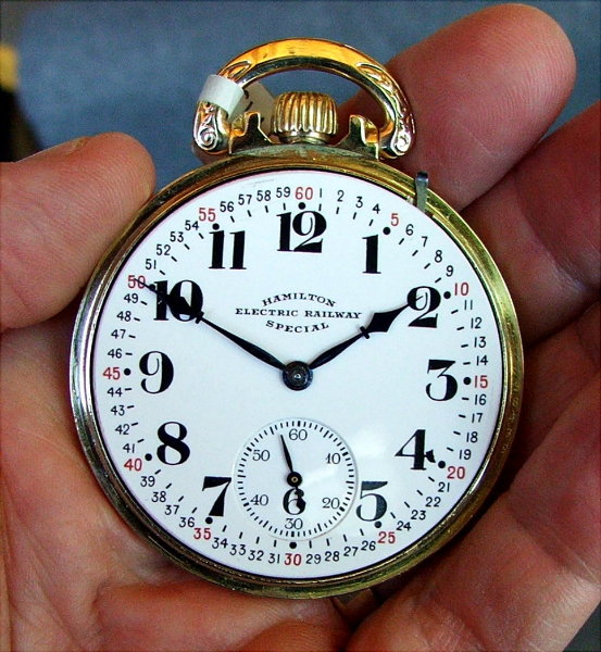

Peter S. BalkanI too would like some specific information on these watches.  My information is based upon the scant description in Shugarts and my own supposition.
First, I am supposing that it was the 974 Special that was usually associated with the Electric RR Spl.   The 974s has a steel escape wheel, double-roller and was usually lever set. The 974 had a brass escape wheel, single roller and was usually pendant set (although a smaller number of lever-set were produced).  I always just assumed that the 974s, with its similarity to RR standards, (albeit only 17 jewels) was intended for trolly use.
Shugart lists a 974s AND an Electric RR Special.  I don't know the dfference so, again, I assumed that the Electric RR Special, would have the dial AND be lever set.
I have two 974s's and have put the Electric RR Special dial on the lever-set model, in the hope that I have met all the requirements.
If anyone has any documentation as to exactly what was required for Trolly use.... I'd love to know.

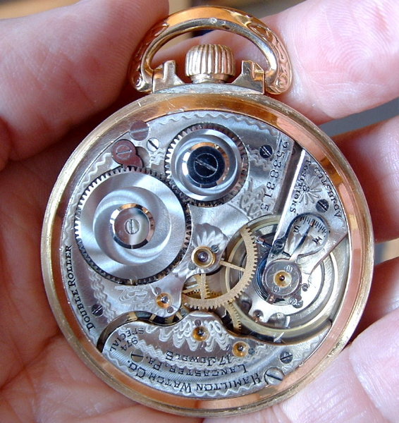

Peter S. Balkan974 Special movement:

Both of my 974s's say "974 Special" on the train-bridge and "Double Roller" on the barrel-bridge.

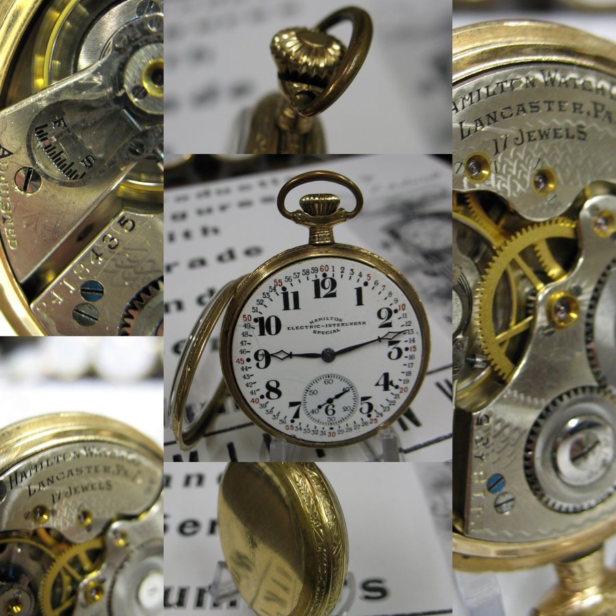

David AbbeThis Pendant setting s/n 2418435 c.a. 1926 has "Electric Interurban Special" dial that is posssibly original for that period. No "3 Pos." marking though.
