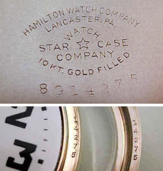

Some time back I used the image you'll see below. In it the "matching numbers" are shown on one particular case. On that example the inside of the case-back is stamped with the complete number. With the merged image you see the inside case-back on top, the frame is at lower-left and inside the bezel at lower-right.
On the frame and bezel the final five digits appear in the representation shown. Sometimes these may be as few as three digits, or they may be preceded by an alphabetic letter. On still other cases the references inside the bezel and on the frame will very commonly be expressed in hand-scratched roman numerals.
This was intended simply as a way to keep all the properly fit pieces and parts together during the manufacturing process. Some cases we find will have very close numbers, or just one digit will differ on them. Many cases probably started out without exact matching numbers, in those instances they will be a close match.

Matching numbers on all three components...

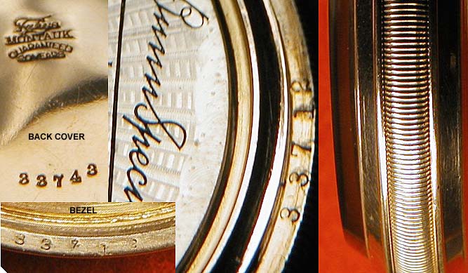

Lindell, great subject, and I was going to post this as a question anyway. Bought this 1923 Bunn Special (21j) about 4 weeks ago; the dealer and I both thought the case ought to be a marked Bunn case, but looking through the Illinois research area, I see mine is too early for that. The case looks original (no extra screw marks, normal wear), but the case nos. don't quite match. The bezel and frame have 33712, while the back cover has the complete sn of 33743. As everything matches, I figure most likely a factory situation.
Hope the pics make it clear.

Very interesting Norman,
I have "close matches" such as yours in my collection as well. Like I said above my tendancy is to accept a close match particularly when they fit well and appear to have the same overall appearance.
There is much we will never completely understand about these fascinating items. And let's face it, we obsess over things that way back when would have been of no consequence.
