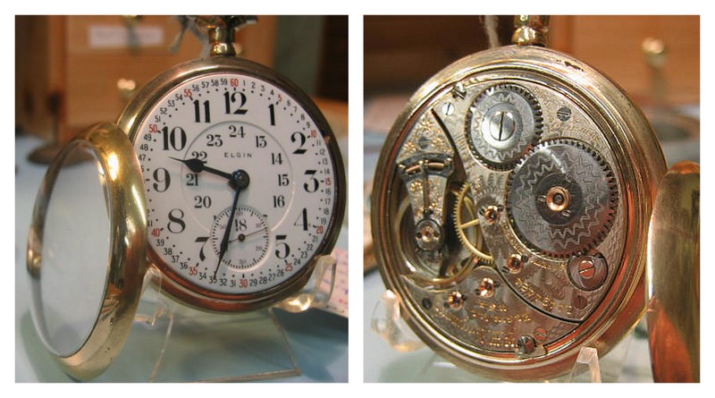

Mark, they are beautiful without a DOUBT! This "lowly" 19J B W Raymond passed through my collection and left a lasting impression.

WOW ! Smile what a beautiful watch, i will dream of it tonight. If my wife finds me smiling in my sleep, i hope she believes i am dreaming of this beautiful watch and not her sister lolo Smile art just teasing about the sister not the watch., art

PS, I just had to down load the photos of the raymond to save and enjoy looking at it and dreaming of it. I hope you dont mind. When you i a beautiful watch like that it reminds me why i started collecting, beautiful american craftmenship, design and instrument for time keeping and in my opinion, a beautiful piece of art. Just my opinion for what it is worth, art
