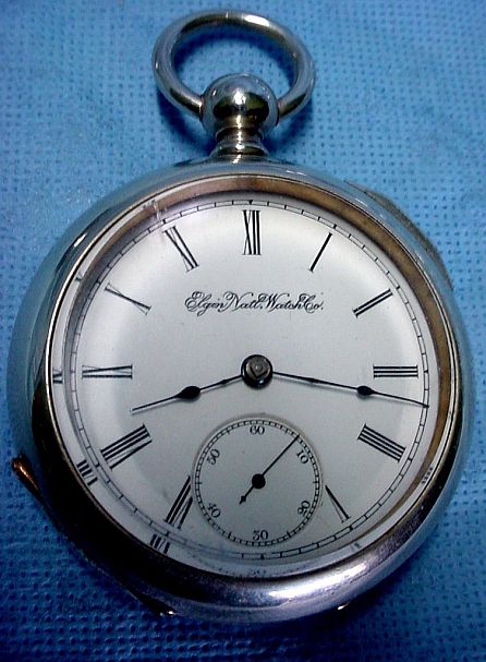

January 14, 2013, 23:58
Donald C. Henderson
I bought an 18s Elgin key wind last year. It dates from 1893 and also sets from the front. I couldn't set it at first with the repro key the seller included but I noticed that the square opening in the key was recessed. I ground down the end of the key flush with the opening and then it worked fine. The watch only has 7 jewels but is in such near pristine shape that it keeps time within 10 seconds a week with the regulator at dead center. It's in a Silveroid case though, no gold or silver content. If you notice, it has no crown which I believe was the norm with the full key wind and key set watches. There is no need for a crown.
The serial number on your movement dates it to 1871 and it says it could have from 11 to 13 jewels. It's a nice find but may not be in it's original case. It also says that it's a Hunter case movement.

January 15, 2013, 00:05
Donald C. Henderson

January 15, 2013, 05:49
Michael D. Carroll
Elgin did not sell Factory Cased watches. You chose what case you wanted from your local jeweler. Elgin keywind watches fit in both Hunter and open face cases. There is a locator pin on the movement that aligned with a hole in the case.so there was only one case screw needed.Open faced cases needed no pusher crown which you find on Hunted Cases. The crown on Hunter cases do not turn.Your Open face case is probably original to the movement
