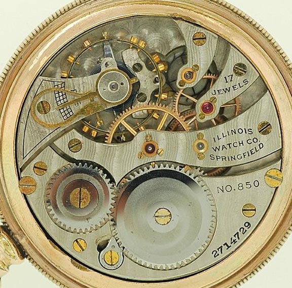

A friend is bringing over a 14K Illinois 16sz grade 850 that she was going to send to a scrap gold dealer. Can anyone tell me the rarity of a grade 850 Illinois? I can't seem to find it in the "book" so I don't have any idea what would be a fair offer in order to keep it out of the smelter. I have seen the watch a few years back and it is in it's original white gold case. The pic I included I found by Googling. Thanks, Harold

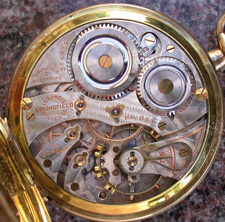

August 14, 2008, 14:53
Harold Visser
Update, well I received the watch, haven't bought it yet....turns out it's a 12sz.and this is the actual watch picture, the following is what I posted on the other board; Yesterday I had the opportunity to save an Illinois from the scrap gold dealer. Not being very knowledgeable on 12sz Illinois watches, I thought I’d just take a quick look at the “book” to get an rough idea on it’s value, but there is no Grade 850 listed, The Ehrhardt/Meggers book does not show a Grade 850 either. The watch has a gold train, steel escape wheel, double roller and marked 19 jewels, but neither the pallet pivots or the escape wheel pivots have cap jewels, so it appears to be a 17j watch to me. Can any of the resident Illinois experts shed some light on the Grade 850 for me? Does Illinois have hidden jeweled barrels maybe to get the count to 19? Is this an unusual grade?
Thanks, Harold
August 14, 2008, 15:28
Robert Schussel
Harold
your watch is a 19j Grade 406 private label No 850 with an estimated production of 92K.
While the No 850 is a scarce private label I think that only avid 12 size collectors such as my self would put any premium on it at all.
The is the same private label No 850 I also own.
bob
