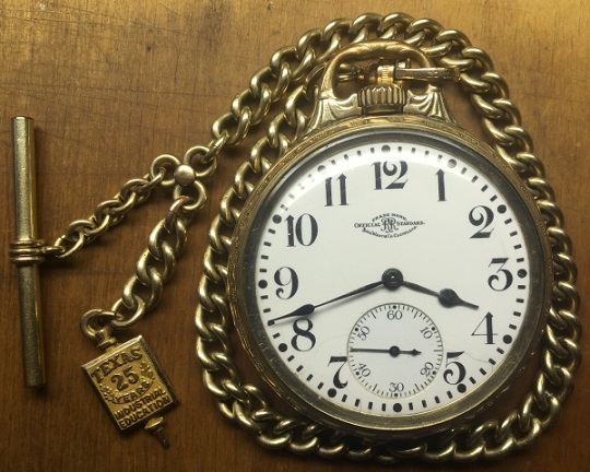

Alan EtheredgeHeirloom Ball RR Watch
I am not a horologist nor a collector but am drawn to seek information on this site alone among the many I found while researching my inherited pocket watch.

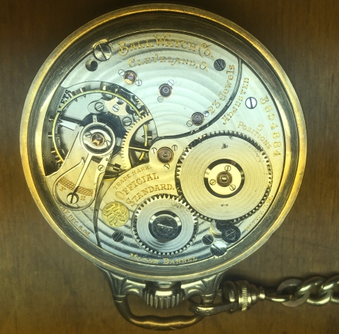

Movement:Ball Watch Co. #B604884; “23 Jewels”; “Official Standard” with gold seal “RR” on the plate

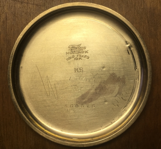

Case:Fahys “Montauk” (10kGF) #460576; “R.R.”
Chain:LESTAGE 1 20 12k GF (marked on last link between the chain and the watch-clasp)
11” length from tip of watch clasp to center of toggle-bar
History:- Carried by my grandfather (1889-1958) all of his adult life (family lore); I do not know if he purchased it new, he was the foreman of the cottonseed oil mill in a small east Texas town (the location of the 'noon-whistle' for the town).
- Carried by my father (1924-2005) only on special occasions; the small 10k gold medallion on the chain is his.
- Stored in a safe deposit box 2005-2019; I recently inherited the watch.
Known condition issues (my very inexpert inspection):
The watch does not run, I do not know if it was running when stored upon my father’s death. The crown resisted very gentle effort to turn it clockwise; the crown freely turns counter-clockwise with a ratcheting feel. With very gentle effort the set-lever extends about 3/32” then meets resistance. It appears a screw is missing in the movement plate left of the “Ball Watch Co.” engraving. To my inexpert eye it appears the mainspring may be broken or displaced.
There are two very fine hairline cracks in the paint (or is that enamel?) of the dial, one between 4-5 and one between 7-8.
The undecorated / plain case back (with apology I was unable to take a usefully glare-free pic of that) is worn with some scratches and very shallow dents but the gold of the case is not worn through except at the inside of the top loop where the chain clasp bears.
My Goal:I would like to have the watch movement repaired to functional without altering the appearance in any manner whatsoever. I would like to use the watch as a ‘bedside clock’, hung in a small ‘display dome’ where it would be wound at proper intervals.

Alan EtheredgeMovement pic #B604884

Alan EtheredgeInside Back Case pic

John WatkinsThat's a fine watch you have inherited. I have a similar story, having inherited my grandfather's Elgin watch. He, too, lived in a small East Texas town and carried that watch his entire life.
From
this source, it looks like your watch is a Ball 999N made for the Ball company by the Hamilton Watch Co. between 1916-1920, probably closer to 1920. I'm no expert but I have found this source reliable in the past.

Buster BeckAny high grade watch such as this always warrants a COA (clean/oil/adjust) by a good watchman. When you add the inheritance factor, it becomes priceless to the owner.
It has a few problems. They are mainly insignificant with it's inheritance factor leading it along. It probably left the factory in a "Ball" marked stirrup bow case. It has a couple hairlines in the porcelain fired dial. It needs a COA and a Hamilton plate screw. It has a few small tarnish corrosion spots on the winding and crown wheel that will always be there.
As it sits today non running, it has a value of $500 as~is. Get it COA'd and a new white mainspring and it will fetch $700-$850. A COA and new white mainspring and a plate screw should be out of pocket in the $150 range (+/- $50).
A nice watch worth restoring any-day without adding it's priceless inheritance factor.

Harry J. Hyaduck Sr.Hi Alan,
I see you have some great advice here. I do see that the case has been replaced. They did a good job as the case screws match. I know you want to keep the watch as close as possible to the way your dad left it but it does need a new plate screw as Buster suggest. If it were in the original Ball case that would add to the value but being 23j it is still a very nice and valuable watch.

Now understanding that the watch most likely didn't leave the Ball factory with the Fasky case (and knowing that my father didn't have it re-cased), how are some ways that sort of change was made 'back in the day'?
Was it common, for example, that a retailer would re-case a watch 'speculatively' prior to it's initial offering for sale? Or, is it more likely that a buyer would specify that at the time of original purchase, or even years after it was purchased?
I suppose I should ask, is the pictured Fahys case of a style and number likely available when the watch was first sold? I'd have the same question about the chain?
All of this guessing of course but it lends to better informed interesting speculative family discussion about grand (and great grand)father's life. We know he was never a man of wealth and by all indications was quite frugal. We've no way of knowing but it's quite possible he acquired the watch as payment for services rendered or settlement of a debt.
Does anyone have any idea of the (unadjusted) price of such a watch and/or case in the early 1920's?

Buster BeckThe case is a FAHY'S gold filled watch case. The original Ball Stirrup bow style case it came in was replaced sometime after if left the factory in 1920. Most of the time Fahys gold filled cases lasted many years until the gold filled layer exposed it's inner core of brass. So no one can tell you when or why the case was replaced. The retailer would never have changed the case unless a buyer demanded it and I can think of no reason a buyer would do that. Generally we see the Fahys RR marked cases starting about the mid to late 20's.
Here's what Ball Watch Co had to say starting in 1902;
"Many good watches are ruined as timekeepers by being forced into cheap, imperfect sweat shop cases that do not fit properly. We have had some sad results in this direction, and intend to avoid such dangers in future by sending out complete watches only."
The watch chain would be era correct for the watch. This particular 23 Jewel Ball movement would have been used by those that were required to have a Railroad Approved/Railroad Grade watch and generally not by other workers in other industries because they costs more than the average worker could afford to pay for a watch. The foreman of a cottonseed mill would not have to have a more expensive watch such as this 23 Jewel Ball RR watch as a 7 to 17 Jewel watch would be all that he should need or desire in the course of his duties.
I don't have a Ball Watch Catalog from 1920 handy but I would guess that in 1920 this watch would have cost in the neighborhood of $50 new in the correct Ball case.

That's great information and reinforces my suspicion that grandfather probably acquired the watch, already in the Fahys case, second-hand somewhere along the way. It's my understanding that he and the family were relatively fortunate through the depression, cottonseed oil remaining in fairly high demand through those hard times.
The condition of the watch case, the lack of wear on the gold fill other than at the top loop, would seem to indicate that granddad didn't carry this watch all the time (contrary to my father's recall) but likely used it for 'Sunday go to church' or other occasions when he 'dressed up'. All just guessing of course, but fun speculation.

What it boils down too is it doesn't matter when or where the case was replaced. Someone could offer you the correct case now and you would not switch it. You want it just as it was left to you with all the bumps and scrapes your grandfather and father earned along the way.
You can speculate all you want as to when and why the case was swapped but unless someone is still alive that remembers it then that information is lost. Who knows you may find some old paperwork from your grandfather which includes the sales receipt. But until that happens then enjoy your family heirlom just as you found it but with a new C.O.A.

Samie L. SmithHey nice watch i have worked on quite a few of these and when serviced and with a new mainspring you will be surpised how accurate these are.

Buster BeckYour Ball watch is a
lever~set watch which means you do not have to pull the crown out to set it. A back and forth motion is the way most folks wind the mainspring up. Then you must take the front bezel off, and with your fingernail, pull the lever up and then turn the crown clock~wise to set the time. When finished gently push the lever back in but try not to let it slam against the dial or it may crack the porcelain dial. Put your front bezel back on and you are set and ready !

Alan EtheredgeJust a follow-up having received the now wonderfully clean functioning watch back from Chris Abell ...
Thanks, Chris, for the very positive experience! I'm thrilled with the outcome, my family and I appreciate the care you took with our heirloom!
