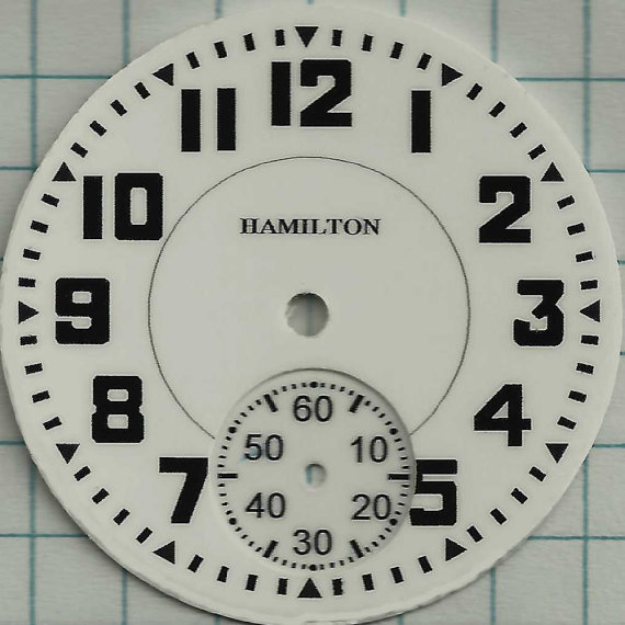

Peter Kaszubski
here is some one making them in very crude way hamilton logo on it he/she also make them for you guess all american made including ferguson,ball and so on
September 24, 2014, 02:34
William D. White
Peter,
I've seen these and I think this seller unloads quite a few at roughly $15 ea. I, like you, believe that the use of resin coated inkjet photo paper is not the preferred method of making watch dials. HERE is a link to show the type of work I seek to parallel. “grand feu enamel” It sounds fancy but roughly translated I think it just means "big fire enamel".

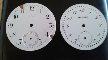

Peter Kaszubski
I do not make them in enamel but so far no complains
pictures of the original and replacement till original in good condition is found as I call them temporary replacement .
October 13, 2016, 12:38
William D. White
Nice job Peter, What is the material? I am still working on my dial project, currently on the imaging/printing.
William
info@whitescrystals.com
October 13, 2016, 14:13
Peter Kaszubski
its same as it been special 3M plastic for laser engraving.
