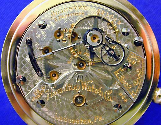

January 17, 2010, 18:06
That regulator was in constant use on all 18-size Hamiltons from the beginning in 1892 through the 1927 end of 18-size production.
Here it is on 552983 an uncommon Model 944 Hamilton...

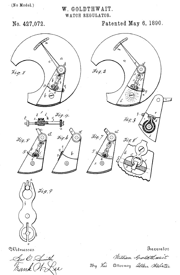

January 17, 2010, 19:31
Here is the patent for those interested.
