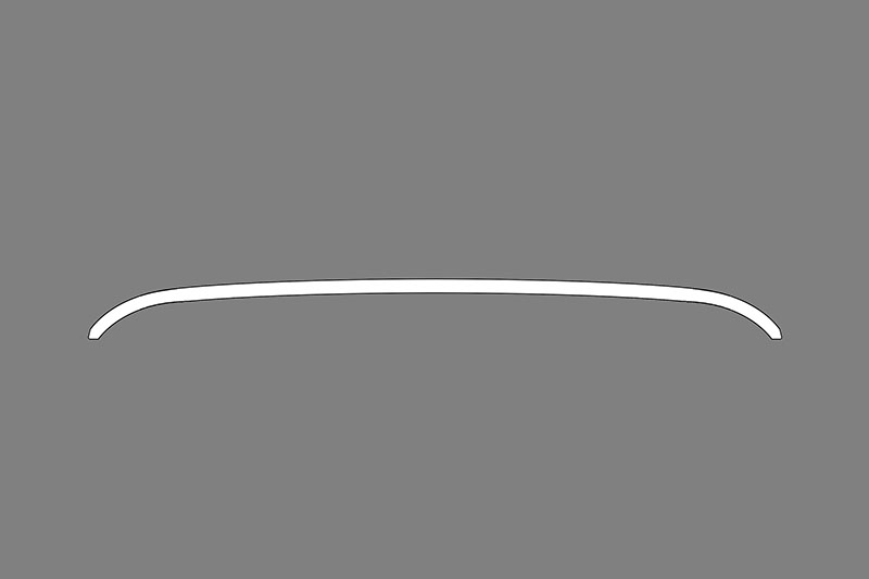

From all that I have been able to learn over the years, mi-chevee or mi-emp crystals were pretty much standard issue for 16 size RR grade watches from about 1920 through 1960. "mi" is french for mid or medium and "chevee" loosely translated means shaped or sculpted. "emp" is short for empire and describes exactly the same profile: raised at the outer edge for tip of minute hand clearance but flattened towards the center to provide a low profile.

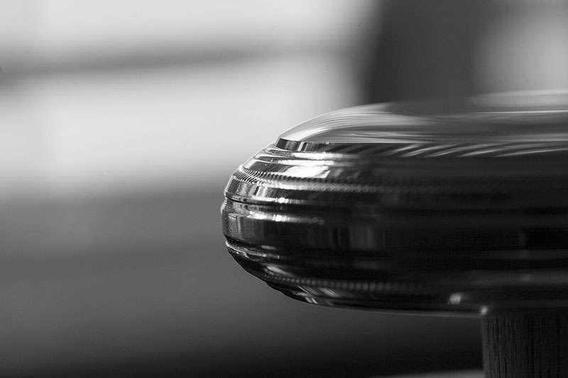

In this image you can see the how the profile of the glass compliments a 16 size RR case quite nicely.

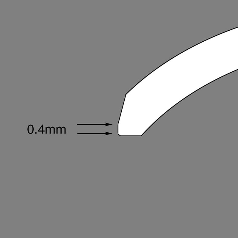

William D. WhiteMy modified edge finish and lower seating is, in my opinion, an improvement over OEM crystals.

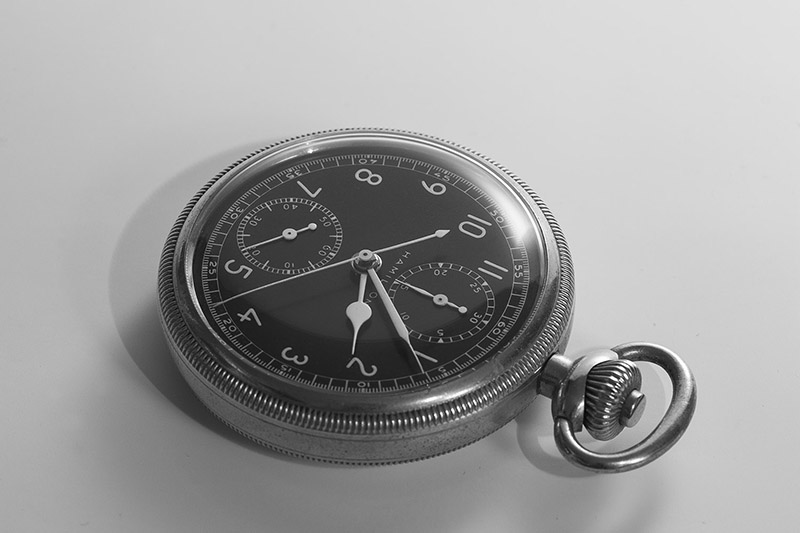

William D. WhiteA slightly higher version is also available for the Hamilton Model 23 chronograph and 4992B variants which need a little extra room for the center sweep seconds. Same price.

Tim Poovey"A picture paints a thousand words"
Your photos and work truly amazes me!
