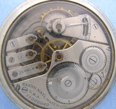

Wayne C. AndersonNeed expert Elgin pocket watch help
How many screws were used in assembling a Elgin 1931 Grade 382 16Size 17Jewel obn7p?

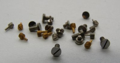

John D. DuvallWayne,
How about 40 screws, NOT including the following:
Banking screws (2)
Micro regulator screw (1)
Safety pinion arbor (1)
Pallet lever arbor (1)
Balance screws (12-18)
Now are you going to help me put my watch back together?

Steve MaddoxLet's see........
Crown wheel screw -1
Ratchet wheel screw - 1
Dial feet screws - 3
Plate screws - usually 7
Pallet cock screw(s) - 1 or 2
Jewel screws - as few as 4, or as many as 25
Hairspring stud - 1 or 2
Regulator scale - 2
Balance wheel - usually 14 or 16
Minute wheel cover - 2
HEY! WAIT A MINUTE!!
I'M ALREADY AT 60+, AND I'M NOT DONE YET!
Dang! Maybe this watchmaking stuff is harder than I thought!
I NEED A RAISE!!!

Wayne C. AndersonThis is the movement - when I take it apart for cleaning I will count them - looks like 60+
