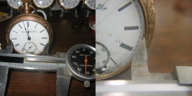

Over a year ago, I bought a crystal cabinet with about 6,000 pocket watch size crystals as part of a "watchmaker's estate" here in Southern CA. I measure the watch crystal rim as shown below, and using a size chart, I had little trouble fitting crystals to the first few hundred Open-Faced watches.
Now, with many "common sizes" depleted, often I Grind the crystal to fit on a water lubed glass wheel (from the same estate). So for open face watches, I will be able to fit many crystals of my own watches for some time, albeit more and more time-consuming.
For the "Hunter Case" crystals, there are myriads of "dome" variations that are required by the equally large variations of cover clearances on those cases, meaning . . . . even with a cabinet full of crystals, "good luck" finding one that works at all, as those are VERY unfriendly to grinding.

Mike, I use my Dial Verniers for measuring most all parts on a watch I am working on.
