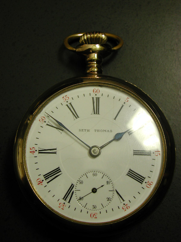

Thanks David for the nice graphics. I figured you'd know since you now have me into Seth's. When I first pulled the movement from the case I thought the lever had been damaged and that someone had installed new crown gears to update the movement to pendent set. Glad it's actually a correct part of this nice running watch. In 24hrs i've only lost 30 seconds. Now I just have to locate a good whiplash regulator. Heres an image of the dial and hands set in a 25-yr gf case that really isn't period correct, but will do for now.
