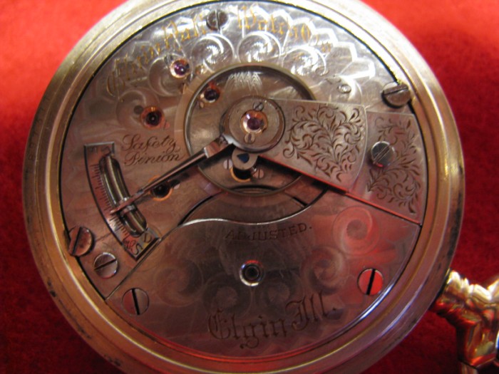

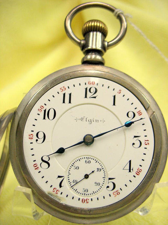

Hi all,
Just received my Elgin 150 today and thought I would ask if this is the correct dial and hands for this watch,I was also wondering if the crown had been changed. Someone has put it in a display case, so I know that is wrong, different screw marks! Also in another post I read that some watches from this same run were lever rather than pendant set, this is a pendant set watch, is this a likely scenario ? This is another large 18s Elgin for my collection. Thanks for any input.
Bill
March 16, 2010, 16:58
Bill Manders
dial
Bill Manders
mvmt
March 16, 2010, 18:47
Claude Griffith

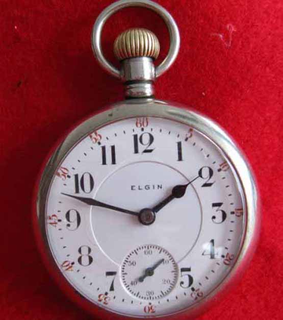

Bill your dial and hands are more than likely incorrect for the 150. Most of the 149's anbd 150's used the Elgin in fancy script with the filigree on each side. Also Pendent set is the typical version, lever sets are much more rare so yours is a typical run and the runs did not go lever, pendent etc. Here is the dial and hands that you typically see on the 149/150.
March 16, 2010, 22:52
Bill, the dial and hands on your watch have all the attributes and condition deserving of a later model RR watch. They are therefore "tradeable" for a more "appropriate" scripted "Elgin" dial and Medium Breguet Spade hands if you wish. If you want to set up a trade, I can rummage for a dial and I have two Elgin parts cabinets full of the correct hands. Just e-mail me at david@glopar.com
(btw, this is my core collection 150 dial pic and I am sure it is all Original!)

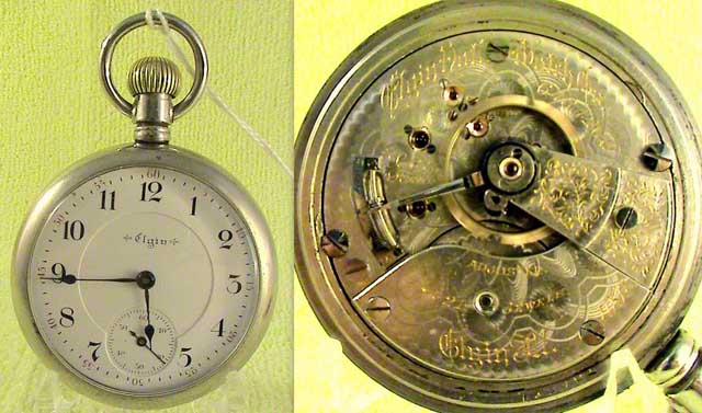

March 16, 2010, 23:24
This is the movment, what incredible Damaskeening!
The s/n is 6424083 which I think makes it a "Kissin Cuzzin" to yours
March 16, 2010, 23:25
collage

I think prior to 1900's it was not unusual to see an open face have a Roman numeral dial, and my 149 has a Arabic numeral dial but both have the fancy Elgin script with the filigrees on each side and both are double sunk with medium spade hands. I would agree with Dave if you can swap for the correct dial and hands I would, neither version 18 or 16 size of this mid type Elgin dials are easy to find. I think up to the 30's there were three types of lettering on the dials, fancy Elgin National Watch Co, like the ones that Dave and I posted and the later block Elgin like on your dial.

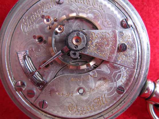

April 12, 2010, 21:20
Bill's looks like this now . . .

April 13, 2010, 12:25
Claude Griffith
The dial looks very correct now, but on the back shot the regulator seems to be out of its slot on the micro adjust wheel. These are nice grade Elgins, I have both 21j version of the 149 and 150 both lever sets.
April 13, 2010, 21:18
Yes, I noticed the regulator too. It moved slightly while I had the Balance cock off to regulate the watch and I did not notice the thing had moved over slightly, but that was not an issue at that time.
April 13, 2010, 22:18
Claude Griffith
I have picked up a few full plates off ebay that had the micro adjust nut in one location and the regulator arm in another so after a couple you notice them like they were a red light flashing.

April 23, 2010, 15:49
Bill Manders
I just got the watch back today from Dave Abbe. Once again I have to say what a pleasure it is to belong here, knowing nothing myself, but being able to get the information, and good will from all the far more knowledgable people here. I sent the watch to Dave to replace the hands and dial with the proper period correct ones which he so willingly stated he had and would trade me, with my shakey hands and failing eyesight he offered to change them for me, which I gladly accepted as I know without trying that i would have bent/broken the hands, and who knows what would have happened to the dial if left to me ? While he had it he stated that the watch was quite dirty, and needed a new mainspring, adn when asked if he could do it while he had it, there was no hesitation in him doing the work, through earthquake and all. I am so pleased at the job, I now have a period correct piece, and I am sure it will run for years to come.
Thanks again Dave, and all the members here for if nothing else, putting up with the less knowledgable people.
Bill
I am enclosing a couple of pics of the "new watch"

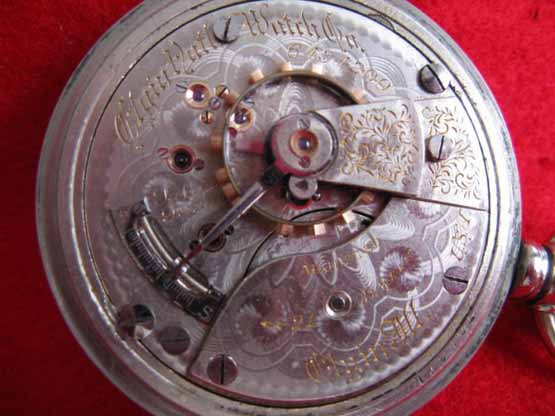

April 30, 2010, 15:22
Bill Manders

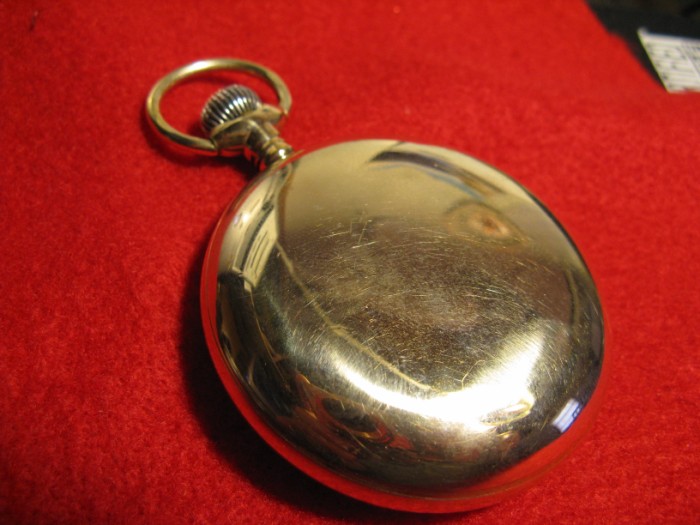

Hi all,
I just received my 2nd 150 today. Enclosed are some pics for your appraisal as to authenticity etc.This one is not marked grade or jewelling.
Would all of the 1st run ones been 20j instead of 21j, as this is 29 of the first run. Also as seen in the pics, the dial is different from the others, but this was made 1895 ? The fact that this is the 1st run, and should likely be a 20j movement, can someone say with any certainty how many were actually made in 20j, was it in fact the full 1st run of 1000 movements or a partial run ?
Enjoy and comments please !
Bill
April 30, 2010, 15:23
Bill Manders
mvmt
April 30, 2010, 15:24
Bill Manders
mvmt2
Bill Manders
case
