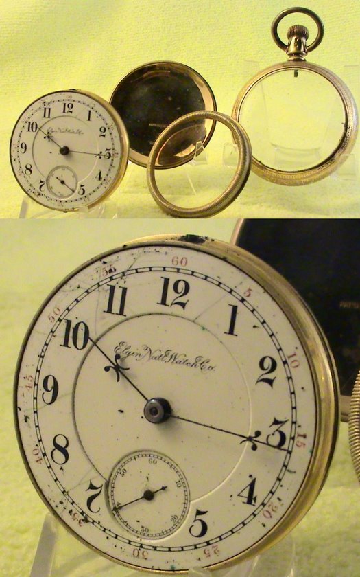

Last week I offered this "ol watch" for someone to bid on! I did note that it had a kinda neat 4 piece case.

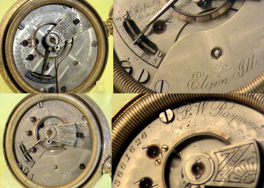

and Perry entrusted me with my offer to clean it up and check it out. Well . . . guess what! Perry you are the winner of a rare and beautiful early railroad grade fully adjusted rare cased Elgin Grade 116 that not only cleaned up beautifully . . .

and runs perfect! . . . . BUT

It has a fully functioning STOP WORKS MAINSPRING! So Perry you have a doubly rare watch indeed! Judging from the 24 Service marks on the original case, I am sure (Cool) this beauty STARTED A WHOLE LOTTA TRAINS!

Perry just a "FYI", the stopworks is one of the Swiss "Geneva Mechanisms" invented originally to control movement cyclically and then applied to Fusee watches to maintain chain tension necessary for those movements. Later it was found that stopworks also helped "improve" time accuracy by assuring the watch mainspring tension was high enough for good operation and also to protect the fully wound watch from being dangerously "locked up" at the full wind position which could cause a disastrous mainspring shrink breakage if the watch was chilled suddenly after winding.
