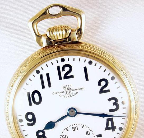

Here are some photos of a Ball Record 435C with the lever at 11 o'clock
March 19, 2013, 15:18
Larry Buchan
I purchased this watch in 2009. you can see the characteristic No.4 that the Swiss used for their dials.
March 19, 2013, 15:26
Larry Buchan
The movement is housed without modification in a American Keystone J Boss yellow gold filled Ball Official RR Standard case. So American movements should fit in it quite easily.
March 19, 2013, 15:59
As explained in my previous post, any marked as "Ball Model or ORRS" cases with lever cut at approximately 56 minutes was designed and intended for a Swiss Record Watch Company 435B and 435C movement such as Larry showed in his images above. The case on Larry's watch was specifically made for use only with Swiss Record movements as evidenced by the lever-cut. Placing an American movement in a case like Rob described and Larry shows would then entail the cutting of an additional lever-cut harming the value greatly to future collectors.
Let us be clear on this, although an American Made movement could in theory be placed in such a case it is only reasonable that no serious collector of Ball Watches would put any Ball-Hamilton or Ball-Waltham in such a case because they would then end up with a lever-cut on each side which would significantly reduce overall value.
