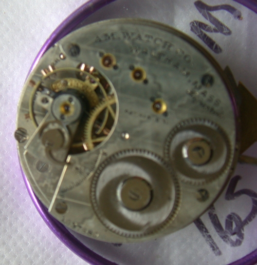

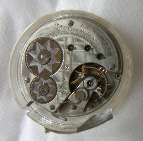

The photos below show differently configured model '72 movements. I'm hoping someone can shed light on this.
I expected them to have the same orientation, as they are both 15J and Grade Amn.W.Co. from production year 1882.
The first pictured below has serial #1801823 and is named in the database: Amn W. Co.
The second has serial #1637980 and is named: Am W. Co.
Same grade, with slight difference in name.
Same tadpole regulator.
Per Ehrhardt's Waltham I.D. book, there is one other significant difference: the first is marked grade of material A, while the second is marked P.
Is the slight difference in names meaningful, and what is the difference between P and A material grade? I could not find an explanation in this book.

2nd movement; sorry for the blurriness:

I believe the first movement is an open-face movement, while the second is in hunting-case configuration.

The "P" material designation means adjusted to normally 5 or 6 positions and the "A" material means adjusted to Temp and maybe up to a possible maximum of 3 postions. Also "P" material is usually the finest material used for pivots for that model type.

In the Waltham ID guide book both these numbers refer to the "Am. Watch Co." grade. If you see Amn. Watch Co. it usually refers to the" American Watch Co " grade, which is a different animal altogether - one of Waltham`s highest grades if not the highest.

I'll think you'll find Derek that the "American Watch Co" Grade is marked as exactly that. "Am Watch Co" marked watches can be "Amn grade" which is not the "American Watch Co" grade (which is the highest quality as you have said), but another grade type all together. This does not preclude the one that is marked as "P" material Ken has shown, from being the highest grade in it's class and model type with the full range of positional adjustments. Wink

The "P" designator has been explained to me by some who discussed this with ex-employees of the W. watch co as meaning "Premium" grade. Suggesting more effort was given to the fancy finish treatment of the "P" movements.
My Waltham Database used in Ehrhardt's book shows both serial numbers listed as AM.W.Co. and only differentiated by the "P" for the 1637980 and "A" for the 1801823 and of course the different case types.
In looking at the movements themselves, the fancier damaskeening including the winding wheels on the earlier model may distinguish the two more realistically according to "A" and "P" than any speculation about mow many positions these were adjusted to. Such details were less stringent in the 1880-1881 time frame of these watch's manufacture.

I prefer the damaskeening on the first movement with the lesser "A" quality.

When I get a chance to dig-out the data I will make a more detailed explanation of the grading, unless someone else does it before hand, David is correct that the "P" designation is for more of a premium grade, but I think you will find that applies more to the adjustments and the materials used than the damaskeening.
I have had a dozen or so of these movements (very few cases unfortunutely)and a lot of the "P" designated ones especially in the earlier serial number runs were not highly damaskeened, does not mean that they are not out there thou.
As for the cases, they are very different, the correct openface cases have the double front bezel arrangement, nigh impossible to find in my experience (which is limited). The hunters are a slightly different story, they are an odd size so before you cut the lever slot you need to check a few things. The model 1872 especially in the earlier serials have a thicker then normal dial plate and also a larger circumference therefore the case you use must have a deeper lip whre the dial plate sits and needs to be of a 17s size front opening, the later serial runs of these you tend not to have this problem (on the ones I have seen}.
You need to look carefully when buying these movements as I have seen some of them with machined dial plates to fit a normal case. Also, the top plate on some runs can be of an odd size (17s) as well, so you will find a lot of cased examples with machined rear case openings. One last thing, the case needs to have a sleeve and female stem that takes the screw in the case pendant neck. Very sorry for the long winded post, just probably should of said, "buy one in a case". Big Grin
