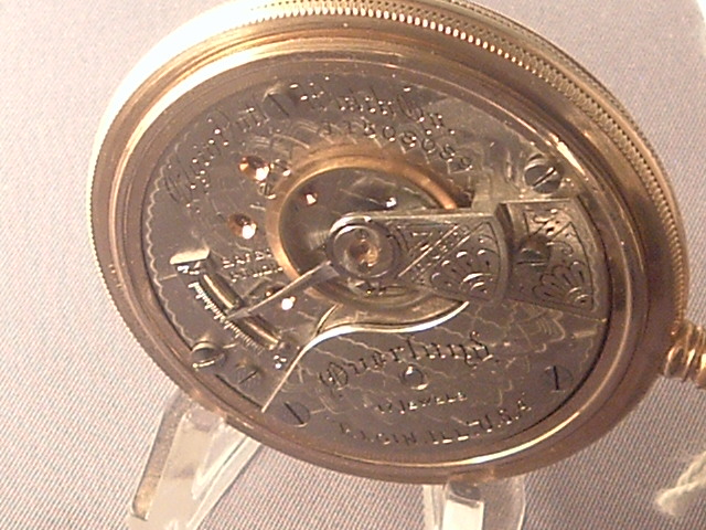

Just acquired this 17 jewel,adj.18s.sw/ps.Movt.marked Overland s/n 11508089 in a pretty nice B&B Royal GFC.Sets and runs well.All three hands are a beautiful blue although they show black in pics.Does this appear to be original? Thanks Roger

Movt.#1
March 24, 2011, 22:22
Roger Stephens
movt#2
movt#2

Serial Number SN Range RunQty Name Year grade size code jewels Adj/reg/etc.
11508089 11507001 2000 OVR 1904 279 18s ofn5p 17j Adj
last run of grade 279; only produced for 2 years;
6089 of 7000 in grade
grade total runs first yr last yr class size code jewels Adj/name
279 7000 5 1903 1904 9 18s ofn5p 17j Adj / OVR
Class 9: 18s OF fp pend model 5
44 69000 made 15-17j U-A Marked GMW or None.
75 98000 made 15-17j U-A Marked GMW or None. gilded
123 13000 made 15-17j Adj gilded
124 13000 made 15-17j Adj
147 6000 made 15-17j Adj Marked GMW or None. gilded
148 33685 made 15-17j Adj Marked GMW or None. not sure which naming is more common
279 7000 made 17j Adj Marked OVR.
the informations what I found, I wait what is useful for you Roger.

Roger, the movement has been recased into the present case....
Since the movement is a 1904 vintage the hands on the watch are railroad watch hands of the 30's & 40's introduction, I would expect to see Elgin #2059 or #1319 hand sets on an original....the second hand is a correct #2066 hand....
The dial looks to be a D-45 and is a correct dial for the movement....
That is my take on the watch, Roger....It may not be an original configuration but would certainly make a fine carry watch....

Thanks everyone,Jerry you confirmed what my thoughts were about the watch.I do have a case that will work but I need to find the hands.Thanks again Roger

Roger, if you like the case that you have now, I would not change it because no matter what you do the movement will still be recased....and the case you have now looks like a nice case....
You can go here to the Elgin database and take a look at the Elgin hands and it will at least tell you what to look for....
Elgin Documents & Pictures.... look at the #2059 or #1319....

Jerry,I have to concur with you.It is in a nice case,with the exception of the bird on it,just don't like birds on cases.Thanks for the Elgin info.I printed it out I know this will help me.Brad,I could not find my hands on the site.They had some for Elgin's 16&0 sizes.Some Hamilton"s& Illinois hands.The hands on my watch look to be either Illinois or Hamilton.Thanks Roger
