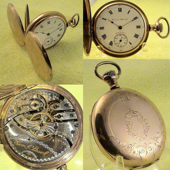

Mike, your movement is a hunter style, so the set lever is correct for that style. Below is a properly cased 16s Hampden Hunter that passed through my collection with that same lever position. I strongly suggest you look for a hunter case for that movement. The dial art is quite valuable and would make that very
collectible.

Thank you everyone for the advise. Most of what I collect is 18 size so I only have 5 16 size watches, 4 of which are openface. The only hunting style case I have is a pendant set with no slot cut.
Sounds like I need to keep my eyes open for a hunter lever set case and if necessary - modify one.
