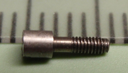

I have a similar watch with a broken balance staff. I pulled a screw from each plate & photographed them.
This 1st one is from the mainspring bridge, the raised one, if you notice it has a very long head, the scale is MM.
screw01
January 01, 2010, 10:43
This is a screw from the bottom (lower) plate, it has a shorter head.
If you need photos of any other parts let me know & I can take this one apart.

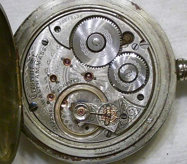

Here is the movement
move

Hey Tom, I have the same screws in my movement. Problem is when I put the short ones in the lower plate,they will not secure the plate. They tighten up just fine,but the plate will still move up and down a few thousands of an inch. If your watch is a single roller balance,I have a good balance assembly in this parts movement. It is missing all the screws,and a lot of other parts,but the balance is perfect. Let me know if you can use it. I'm gonna go pull some more hair out trying to figure this screw(y)thing out. Cecil

Cecil, sounds like your screws are bottoming out in the threads, you could file a little off the thread end of the screw to make sure the head is pulling the plate down tight.I just changed the dial on my 21J Vanguard, so I have a dial, if you haven't already found one.....Ted B.

Hey Ted, It's funny,in my younger days I might have thought of that,the screws bottoming out. But, I just checked,and the screw holes go all the way through. Nothing to bottom out on. I'm gonna take it all apart again,and try putting just the bare plates together and see if I can figure this out. It really doesn't make any sense,and seems like someone with my "able to fix anything" ability should be able to handle a "simple problem" like this.

Tom,It took many failures before I got so I could replace a staff,but now it is pretty simple. I still mess up every once in a while,but it is all part of the "fun" of watch collecting. My Crescent Street has the correct click,but it is blue instead of chrome. It looks rusty in the photo,but it is actually just blue. I'll keep an eye out for your movements,and try to get a couple when you put them up for sale.

Thanks Ted. I finally sorted out the problem with the screws. Works better when you put the correct ones in. I thought it odd that the click and the balance bridge screw were blue and all the other screws that I was trying to put in were chrome. Well, I found a plastic bag,in a drawer with all the blue screws,and the hands,and hour and minute wheels for the watch. The silver screws that I was trying to put in,go for the 17 jewel Bartlett movement. That's what happens when something is taken apart and a year passes before being put back together. The memory fails,and the parts get separated. Looking forward to getting the dial. Got the case all cleaned and polished,and all the parts together,finally. Will put up a picture when it is finished.
