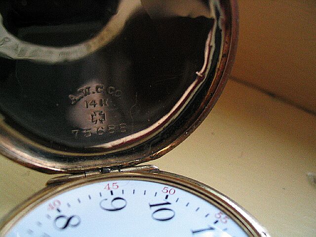

...would ask for confirmation of the 'mark' on this 6S Waltham HC...is it 14K solid or gold-filled?...thanks...

It is gold.

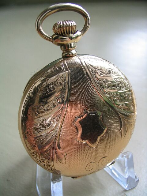

...thanks Jeff...your 'at-a-distance' assessment is confirmed by a feel & listen test that Lindell 'walked' me through over the landline this AM...Lindell first had me place my thumbs on the center/inside of the front/back and cuvette lids w/my index fingers placed opposite center/outside and had me 'feel' test for rigidity...had me compare that feel w/that on a 6S 'Cashier' 25GF HC case that I have and the difference in rigidity between the two was dramatic...the case shown here was much less rigid and much more supple than the GF 'Cashier'...also, the pitch of the sound of the lids closing on the two cases differed dramatically as well...thought that heavy 'buttery feel' and lack of brassing on an otherwise used/worn case was well founded...thanks much fellas!!!PS...the case front....

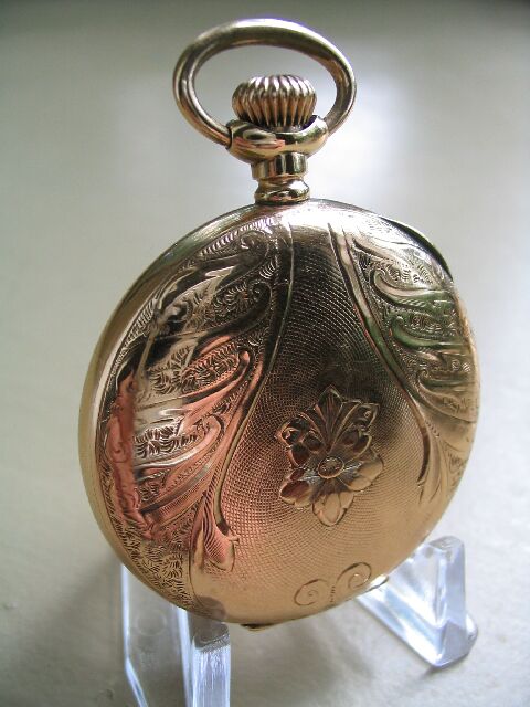

...and back...

The case is not a Waltham.
It was made by the American Watch Case Co.

...Brian, my reference should have read;- "confirmation of the 'mark on the hunter case for my Waltham 6S watch"...

Interesting point. Just how intertwined were the two companies? A lot of people expect Walthams to be in A.W.C.CO Cases as if it adds authenticity.
We have the same thing with South-Bend Watches and South-Bend Cases.

Just passing to say that the case is beautiful, from a great lady I imagine..

The case is fantastic.

I believe the A.W.C.Co. American Watch Case Company was located in Canada. They made cases for Waltham but I think that was the only relationship.
The A.W.W.Co. Was Waltham as well as A.W.Co.

As we handle more cases we develop a "feel" for their content. The "gold-filled" process is a layer of gold over hard brass, hence no "flexing" as we find in a gold case.

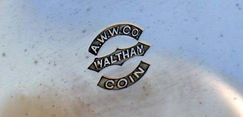

Sounds like placement of the periods make all the difference. Below an image of the mark on what I believe to be an originally cased "1872 Model" Waltham 16-Size.
So then is this one "American Waltham Watch Company"?...

Sure is Lindell.
The C.Co. with the A.W. tells me, American Watch Case Co. and these were not made by Waltham.
