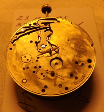

Another assembly detail.
This E. Howard has a snap fit dial. It also has a wristwatch style clutch and lever arrangement for the stem. I could not for the life of me get the stem retainer to capture the stem properly...
I figured out I could install the movement in the case ring minus the dial. This gave me a great visual of the levers and clutches from the front side as I set the stem.
Then I trued the movement in the movement ring and seated the dial with the movement mounted in the case.
Worked like a champ.
This watch is the circle triangle arrow model adj to 5 positions.
