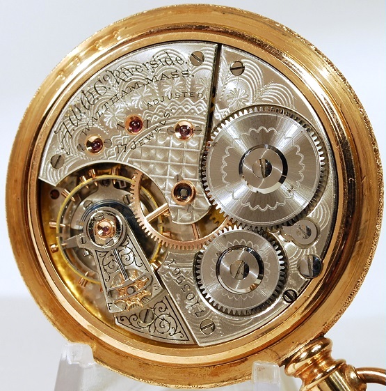

Eric UnseltThe Model 88 is to Waltham what the Sangamo Special is to Illinois; in other words, they both take something like a 17-size case. They had only one case screw, left or right of the pendant depending on hunter or open-face, and a guide pin located roughly opposite the lone case screw that sat in a drilled hole in the inner rim of the case frame.
Notice the single case screw on one of mine below. Unless the movement came with a case it will prove difficult to find one. Of course, anybody with a lathe can open the frame opening by .9mm to allow the movement to drop in. Landing the guide pin hole in precisely the right place (up or down, in or out) is a lot harder.
