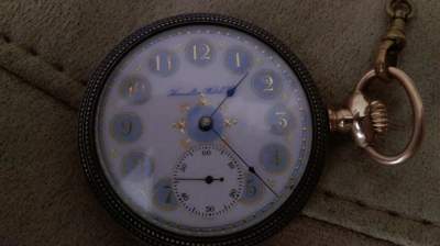

Jamie Strasser
Pic

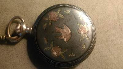

Jamie Strasser
Case

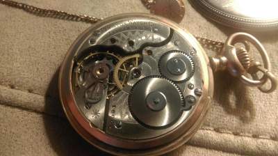

Jamie Strasser
977 s# 69091

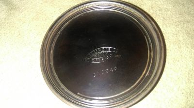

Jamie Strasser
Illinois watch case co

Steven Ford
Jamie,
That looks like a keeper!
Nice dial and Maybe a sterling and gold case.
Database says---
Manufacturer:Hamilton
Manufacturer Location: Lancaster, Pennsylvania
Movement Serial Number:69091
Grade:977
Model: 2
To Finishing Dept: Aug 27, 1901
Run Quantity: 100
Total Production:5,730
Jewels: 16j
Movement Configuration:Hunting
Movement Finish:Nickel
Movement Setting:Pendant
Plate:3/4 Plate
Adjusted:No
Adjusted to Temperature: Yes
Railroad Grade: No

My biggest question, is this the original case? I haven't been able to find pictures of other ornate Hamilton dials, does anyone have pics? From what I have found the movement was 1901 & the IWCC emblem dates to same time!? I am new to the game and very interested, if you have the time load me up w/ info! Thanks

Nice watch Jamie.It is a hunter movement and should
be in a hunter case.Not the open face case it is
presently in.

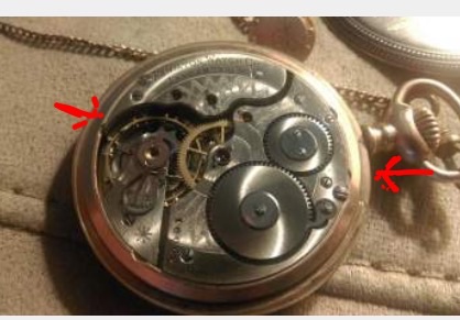

Hello Jamie
I reposted your photo showing where there are 2 other screw marks from another brand of watch. The good news is the case someone put your watch in. Is a GREAT one.
That was not uncommon, either the case was scraped when times got hard or the case wore out.

As Roger said, the case you presently have it in is not the original case. It is a hunting style movement with winding at 3 o'clock and came in a closed face hunting case that you pressed down on the crown and the spring loaded front lid sprang open to observe the time.
Hamilton made "fancy" dials for their watches. The movement was manufactured 10/10/1901 and shipped to Wheeler & Co. in New York the very next day, 10/11/1901. TOTAL PRODUCTION of the Model 977's were 5,730 as Steven said. While the Illinois open face case is from the same era as the movement, there is no data base to support exactly when the case was produced.

The multi-color style Hamilton dial is rarely seen on the 16 and 18sz movements - Jamie. These types of dials are extremely fragile. Therefore, the examples that are "perfect" w/o hairlines or damage carry a nice premium.
Sure the movement was most likely housed in a hunter case, not an open face case (re-cased). However, yellow gold filled cases were only designed to last so long (hence the 5, 10, 20, or 25 year warranty stamped on inside back lid). Also, some individuals prefer an open face case on a hunter movement (they call it a "sidewinder" ) Big Grin.
The case appears to be a two (2) tone model with maybe a sterling silver (92.5% pure silver - hard to read the marking on the inside back lid) bezel/back lid and Yellow Gold Filled main body to the case. Like the heavy petina and the contrast with the flowers on the back lid.

I may be way off but I believe the 977 to be a "cheaper" model? It seems unusual to me that such a beautiful dial would be attached to a 977? The details in the dial are beyond the capabilities of the download, and is perfect as far as I can tell!
September 23, 2015, 07:47
Rob Carter
Hi Jamie this is a fairly early Hamilton and this movement would require a 4 footed dial which yours should be. Hamilton switched to the 3 footed dial around serial # 870,000 (est.) The movement is also the early detent model (I think I see a detent screw below the pendant area) which requires a special case into which the detent stem will fit. So although not likely an origianl case it is suitable. The hunter version cases for these detent movements can be very hard to secure. I believe the Waltham 88 cases have the same detent set up and will work on these early detent Hamilton's.
Lastly, I would probably not call this a "cheaper" Hamilton as Hamilton only made medium grade and up watches with very, very few exceptions. So I guess if compared to a 23J 946 or 950 it would be a lower grade watch, but still a very nice timepiece!!
Fact is it is not unusual to see low grade movements in very expensive gold cases. So the combo of your dial and movement would not be strange in my opinion. Buyers could have requested such a combo.

Would it be possible to determine what movement was 1st in this case by the position of original screw marks (pointed out above by Eugene)?
September 24, 2015, 17:29
Jamie,
A comparison of those case-screw marks with other watches in-hand is the only way to figure it out, I have often done that when trying to put things back to the way they began.
If you can take a bright, clear dial image send it over to me at ihc185@roadrunner.com and I will do my best size and crop it to post here in this topic.
September 24, 2015, 17:32
Peter Kaszubski
I see two set of screw marks in your case so it did have 2 different movements before, not surprise with those silver and gold cases,
IMHO I would just fix the watch and enjoy the way it is, great case and very hard to find dial.
What you will do is up to ya there is no wrong or right way, keep in mind good hunter cases come at a premium price.
Cheers and welcome to IHC185

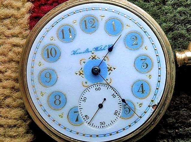

Everyone,
Below you will see Jamie's image, cropped, brightened and otherwise enhanced.
Many collectors call that a "Telephone Dial" because of its design similarity to a rotary phone dial.
I have offered to fill the damage using my unobtrusive, easily reversed method which would be almost entirely covered by an appropriate Hunter Case bezel and at the same time service the movement and see if we can come up with an appropriate Hunter Case for this movement. This is something I enjoy doing and coordinating for IHC Members.
That is something Jamie and I could discuss if he wants to go forward.
Here is the beautiful dial fronting Jamie's 977 movement...
September 26, 2015, 23:33
Kevin Hoffman
that is a work of art , the little blemish won't be noticed when it is in the case . It really is a miracle when you see a perfect dial , to survive all those years is hard to imagine.
September 27, 2015, 07:31
Robert Lee Milliron
That's one of the prettiest dials I've ever seen.
