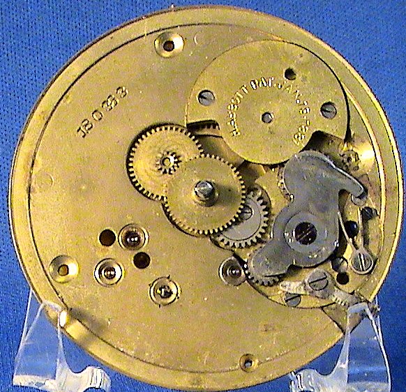

If the lever slides sideways rather than pulling out, it may be an Abbot conversion which should be considered in the valuation. To find out requires lifting the dial which may be held on with pins.

Claude Griffith
Looks like this movement is a later Elgin conversion. The setting lever is at the more typical position of about 25-27 minute postion.
