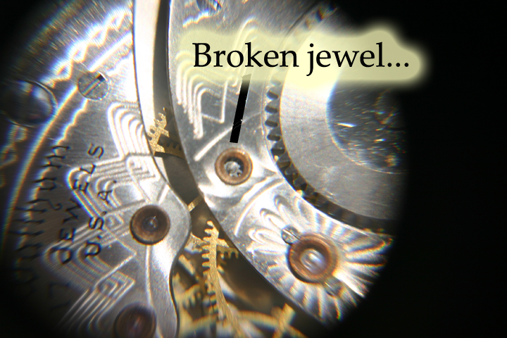

Okay... so I've taken the watch apart again... this time, I discovered that I have a shattered jewel, and the mainspring still won't wind. First the jewel... I think I shattered it last time by not having the cover in the right place when I tightened the screws. Anyway... it is a pressed in setting without hold down screws... how hard is it to change and where can I find a new one?

What is the serial number for the watch, that would help determine what mainspring you need. The jewel part gets a little harder, they came with various diameter holes to fit different size pivots on the staffs, maybe a picture of the movement & the area where the broken jewel is.

The serial number is 24770357. I'm thinking it's the second wheel pinon jewel...
I'm posting two pics... the first shows the whole watch, and the second, I actually shot through the loupe and labled the broken jewel. Not that it wasn't obvious.
So, whatcha' think?

May 30, 2008, 21:18
Hi Mike
Your watch appears to be a Waltham 12s Model 1894, it is suppose to take a mainspring #2224A. As far as the jewel goes, I have limited experience doing replacing them but I think you will need a staking set or a Seitz jeweling tool to replace the jewel with.

Feels like I may be tumbling quickly in over my head! I searched for the Seitz tool and found one on ebay that closed over $200... way to rich for my blood.
Perhaps I should back up a step... What kind of setting is the offending jewel? Friction, Burnished, something else?
Does anyone have a suggestion on where to buy replacement jewels.. mounted or otherwise? I'd really like to tackle this, but I can't spend too much more on tools quite yet!
