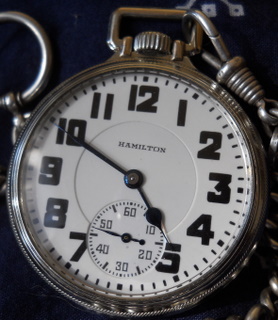

Something like this: Mine was made in 1928, it is in a Keystone Hamilton Model 5 WGF case, a 519 HG dial, blued hands, and "dart" second hand. Regards, Brad

Dana, mine was a "frankenwatch" also...but with patience, hunting, and money, I was able to put it right. And for the $100.00 you paid, you didn't get screwed TOO bad. I am so glad I found this place, as it has helped me immensely in finding out what is correct, and what is not. Matter of fact, I've got a pair of hands that are just like the pair on my 992 that I could give you, just to get you started. Don't have the second hand though, so you'll have to hunt for that. Regards, Brad
