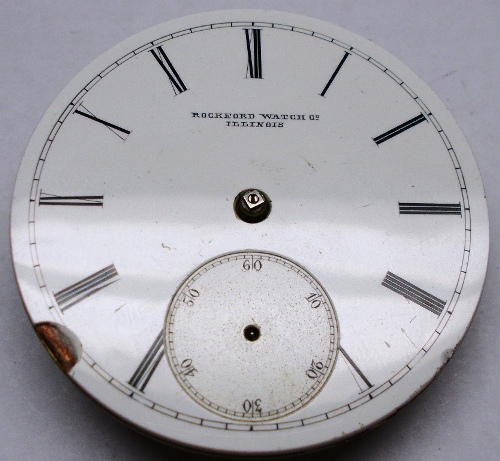

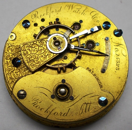

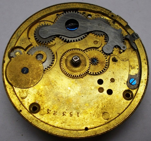

I recently picked up this Rockford movement, thinking it was KW/KS, but when I looked closer, I saw a winding arbor at the edge of the movement.  The movement # is 15323.  I figured this was too early to be a transitional mvmt.
Does anyone recognize this?  Is it factory, or a conversion of some kind?

Harry J. Hyaduck Sr.I just sold two Rockfords like that one. Both were transitional and one even had a very low serial number of 7280. Both had different stem winding arrangements. I posted here and most thought they were conversions and probably Abbott conversions.

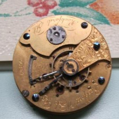

Timothy FitzgeraldI have a transition model very much like it.

Douglas D. WeaverI saw that one, too.  It is an Abbott's Patent conversion.  When I disassembled mine, I found that the winding bridge has the movement serial number on it - so I'm assuming it was done at the factory. It just seems strange that mine, with such a low serial number would be a transition model when the Rockford parts list doesn't show stem winding parts until Model 2's came out - at serial # 115,000.  I'm trying to decide whether to track down the broken and missing winding/setting parts, or just case it as a KW/KS.
