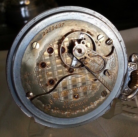

Wondering how checkerboard or two-tone process was done at the factory.
There is good old picture of the damaskeening pattern machine at the factory producing multiple units.
Is checkerboard gold applied everywhere then etched off?
Is it so thin it wears away over time ?
Thanks
Mike
I did search this site and Google, but no luck. The bonus here is access to the greatest minds in PW research. Hijacked photo below.

Mike, two-tone Damaskeening was accomplished by;
1. Burnishing in the damaskeening as desired under the gold plate.
2. Gold Plating over that.
3. Selectively Damaskeening through the gold plating to create the "two-tone" effect by leaving the freshly damaskeened surface showing the nickel color.
