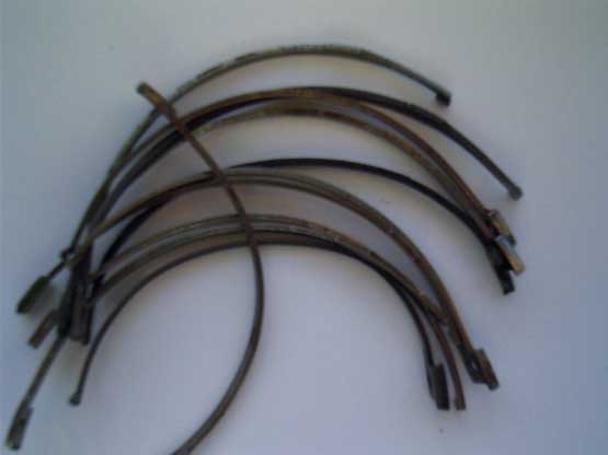

Ted SteuernagelIts real easy to replace one they just snap in and snap out of the movement case. Heres what they look like these are mostly 16s &18s
February 09, 2004, 04:03
Steve MaddoxTed -- Just out of curiosity, have you ever tried to replace a "lift" or "latch" spring in a hunter case?  If so, I'd be surprised you would describe that procedure as "real easy."  For me, it's always been a giant pain........
No two lift or latch springs that I've ever seen have been exactly alike, and every one I've ever replaced has required significant modification to work.  The tips often need to be reworked, as do the hole locations, etc.  In fact, many just won't substitute for others, and there's no way to make them work.
