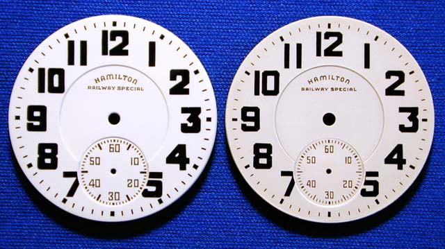

And just for fun check closely, the dial you have may be melamine.
Porcelain HG dials have all squared minute numerals, whereas Melamine Dials will have 45º angles on the 2, 3, 5, 8, 9 and 0 numerals. Check the image that follows carefully.
Below, porcelain HG on left and melamine shown on the right...

How did you know it is melamine, Mr. Riddell?
