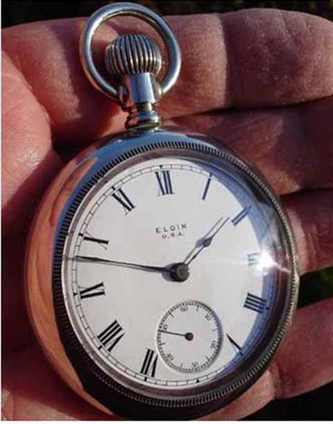

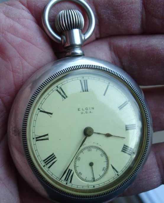

November 23, 2013, 10:02
Stephen John Ward
All finished with a new crystal....thank you everyone.
November 23, 2013, 10:29
Paul Gill
looks great! great job!
November 23, 2013, 10:30
Claude Griffith
Looks like a legit UK Elgin export model (dial has Elgin U.S.A.) and the export models tend to have the same look dial which must have been a favorite with the British customers.
Sometimes the export Elgins can be low production numbers because Elgin would sometimes make changes for the UK market. Nice looking watch and glad you were able to get it back into shape.
