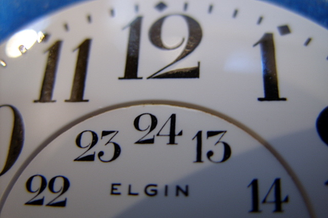

Very good,John-but this isn't damage to the outer edge. I'm talking about either inner edge,almost like a knife was drawn for a quarter inch or so to flatten the definition or sharpness down.
Again,I have seen this two or three times and wondred how it comes about-?
Here's a pic'-but it's not much,I was hoping this was more common...well,you know what I mean!
Marty

I have noticed these small erosions of the edges and it causes me to muse on how they had to finish these composite multiple fired inserts to then carefully and correctly solder them together with the 1 or 2 other pieces. What skill it required to make these with various cutters to finish the OD of the copper substrate and also special cup grinders needed to very carefully finish and chamfer the O.D. of the fired ceramic glaze on the substrate. All it would take would be a "hot glaze" spot where the material crumbles some in finishing to cause these slightly deteriorated edges. It is intersting that Waltham W.Co. only started their Q.C. structure during the 2nd half of their business lifetime. Without a Q.C. regimen, and at least comparative "step" samples to use for judging good and bad parts, the determination of what was "good" may have been all to often based on output demand rather than quality standards!

Dave-Thank you for confirming my hopeful guess about these...defects. I really couldn't see how they could be caused by abuse/accident and etc.
