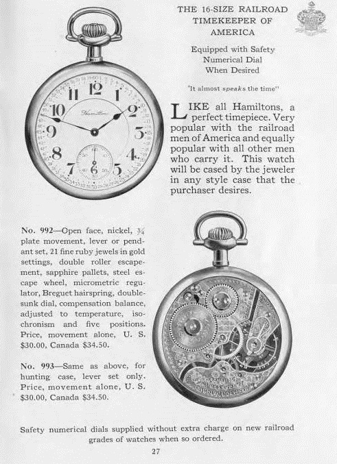

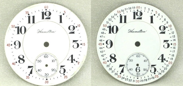

Anybody know off the top what 16s Dial would be appropriate for a 993 from 1913-1915?  Thanks!

Richard RomeroPaul,
Yes, the Gelson list is not perfect but it's the best source we have for Hamilton collectors.
Illinois watches are even more difficult as they produced many "split-run" blocks.
RR
The Hamilton Timekeeper 1914 Page 27

Paul AdamsThanks for your input, Richard!  Yes, those two dials are about what I have figured.  I have one of the one pictured on the left in Great condition and without any defects.  I will probably use that one.  Should have it all back together this week if my other duties allow me.  Then will post pictures as it will be.
