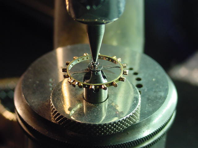

Frist put the remover in your anvil you will notice there is a small hole for lossen or tightening the jaws on the table ,you want it loose enough where the balance can drop down after the roller table comes off.Also noitce the groove in the roller remover it is where the roller jewel sets so you won,t knock it loose when removing the large roller table..
April 21, 2010, 21:23
Samie L. SmithHere is a waltham balance outof my junk box ,,After you remove the hairspring place the balance in the remover and choice a round nose tapered stake just big enough too go over pivot on the staff,,don,t use a flat end stake ..Notice the roller jewel is setting in the groove
April 21, 2010, 21:28
Samie L. SmithThen with a few light taps on the stake with a small hard rubber or rawhide hammer the balance will drop down and leave the roller tables setting on top of the remover..When you do this have your anvil setting back on the bench away from the edge beasuse these will fall off sometimes.What i do is leave the stake setting against the roller tables till i get ahold of them with a pair of tweezers..
Don,t go at this like you are driving nails or you will damange something..

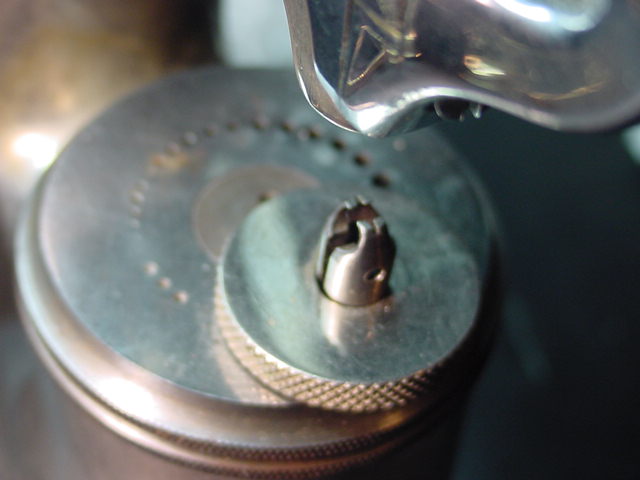

April 21, 2010, 21:30
Samie L. SmithMaybe you already know but if not here is a picture of the type stake you use too drive the large roller table back on the staff..They have agroove in the side again for protecting the roller jewel.
Hope you can make sense or understand what too do i am not the best hand at describing something but maybe it helps..
